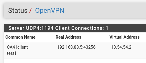

        43256 - remote port from the Status / OpenVPN page:

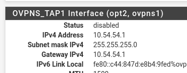

        ovpns1 - interface name from the Status / Interfaces page (or from the ifconfig output):
