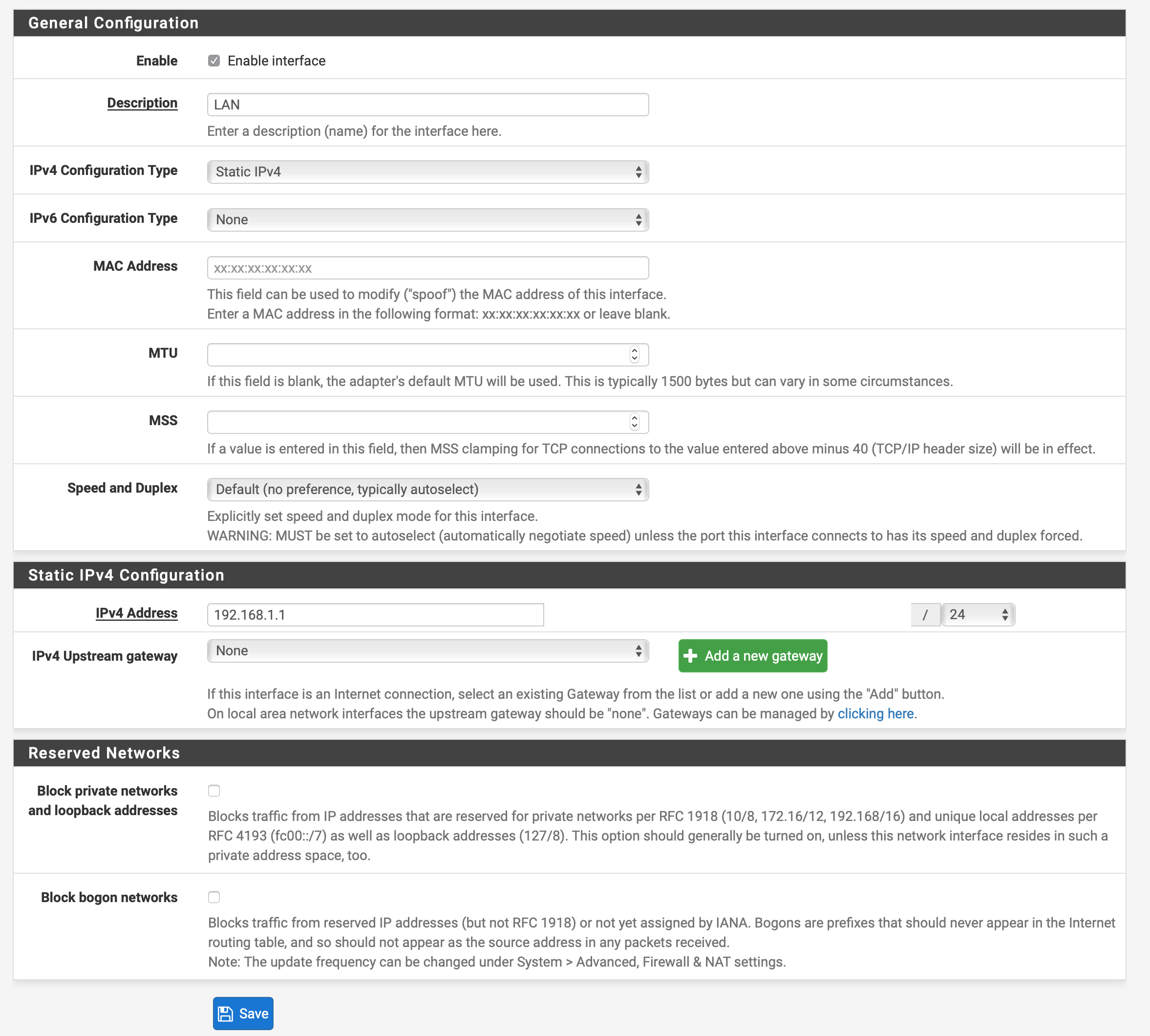

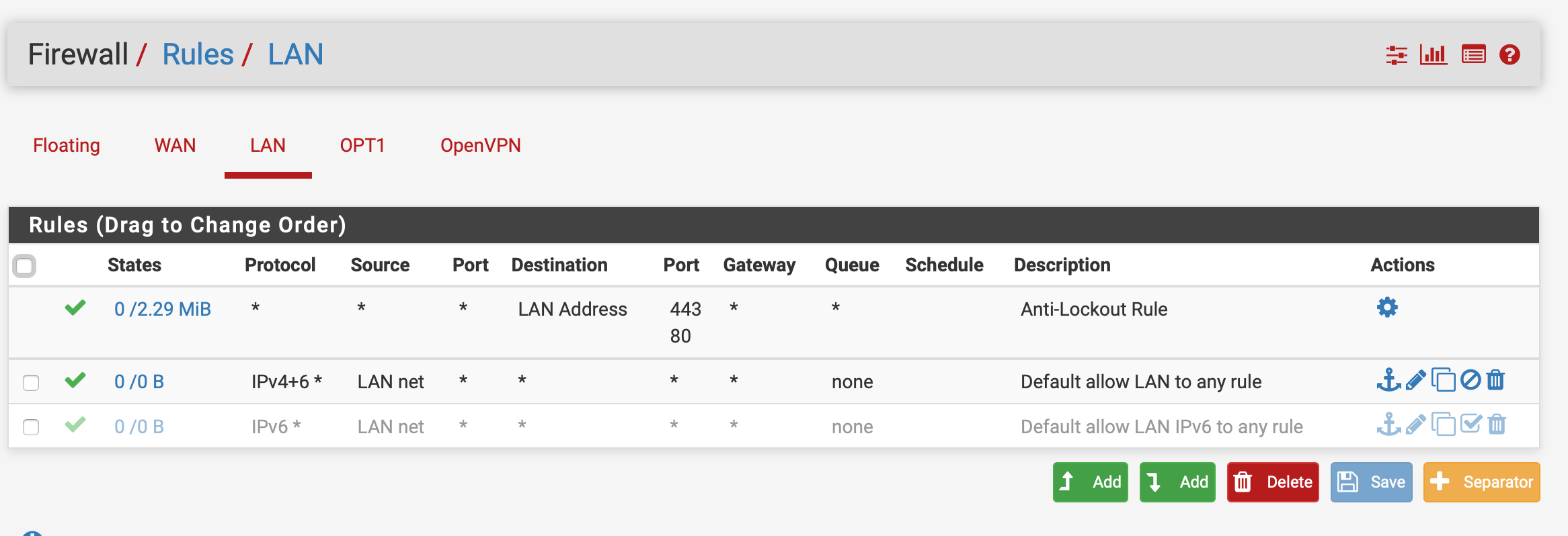

I have an OpenVPN service set up through my OPT1 interface and it is able to connect out through the WAN to the VPN provider. However, now I can not connect through the WAN out to the internet from my LAN interface.
I am stumped. The firewall and NAT rules appear to be allowing LAN traffic out to the WAN.
Screenshots of my settings:
