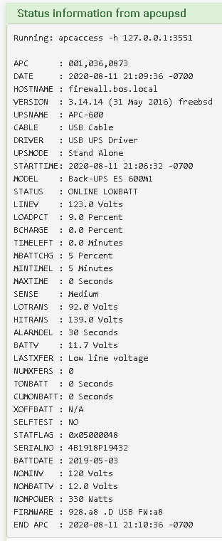

      I had fix the issue, is working, my mistake was that I add the value
      device = /dev/ugen0.2
      Is a USB, there must be blank, the comments recommend this.
      Hello guys.
      I'm searching for a small UPS that works, I test APC BackUPS 600 connected by USB, install and setup Apcupsd.
      After waiting for a while, my UPS lost energy and pfsense didn't turn off my box.
      Done!!!
      Any UPS out there working small factor usb?
      Pfsense 2.4.5_p1, thanks!!!
