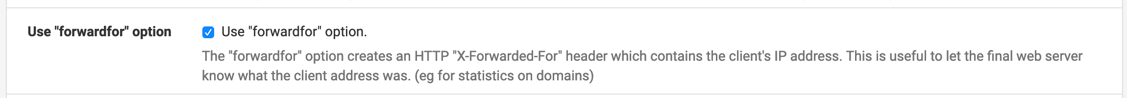

    hi,
    im tryin to get this fixed but hittin hy head hard ;(
    how can i tell haProxy to hand over the client IPs to apache2 logs
    eg ssl_access.log
    the log is pretty useless ;) when there is only the IP of the pfS ;)
    hope someone can shed some light here
    brNP

      Did you enable this in the frontend settings? You might need to instruct apache to log it as desired.

                              The X-Forward-For header option is just a simple checkbox in haproxy frontend settings as @Derelict illustrated above by a screenshot.
                                In the first reply to your question.
                                When you use advanced options like that you remove the ability of the pfSense developers to migrate your configuration as things change in the upstream package.
