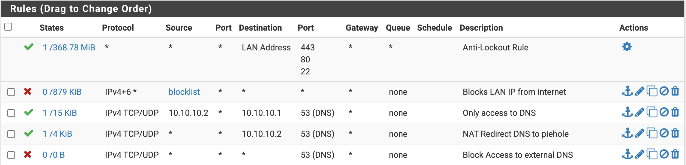

          After a bit of googling i think i figured it out... required 3 rules though. If anything body knows a better way to get this done please share :)
          • Allow single IP (pihole) to access pfsense
          • NAT redirect rule that points to pihole
          • Blocking DNS Queries to External Resolvers
          • Also had to make sure the rules are placed in the correct order
          Did some testing and i think it looks good

            I think I got this working with 2 rules. Everything seems to be working as expected based on logs and nslookup from various hosts, but this is my first time doing anything with firewalls.
            Rule 1: NAT Redirect/Port Forward
            ipv4 TCP/UDP LAN
            Source: (Invert) pihole:any
            Destination: (Invert) pihole:DNS
            Redirect IP/port: pihole:DNS
            NAT Reflection: disable
            Rule 2: Firewall
            Action: Block
            LAN, IPv4, TCP/UDP
            Source (Invert) pihole:any
            Destination: any:DNS
            What is the use of the Block rule, shouldn't the rule above have redirected everything? I suppose i can use it to monitor for anything weird happening since as I understand it nothing should hit that rule
            I also used this article a bit https://blog.flippedbits.io/2020/07/wrangling-dns-on-your-network-part-2-forcing-pfsense-dns/
