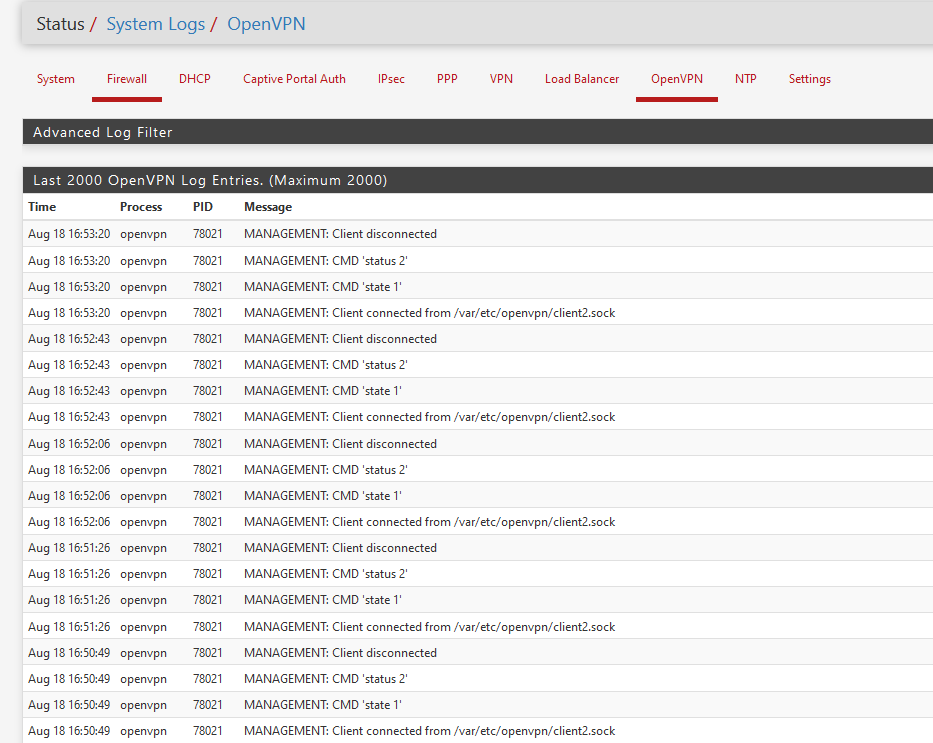

        this is a GUI or graphical representation of what could be found in the OpenVPN logs :
        The manual way :

        This is what is shown - normally, in the logs :
