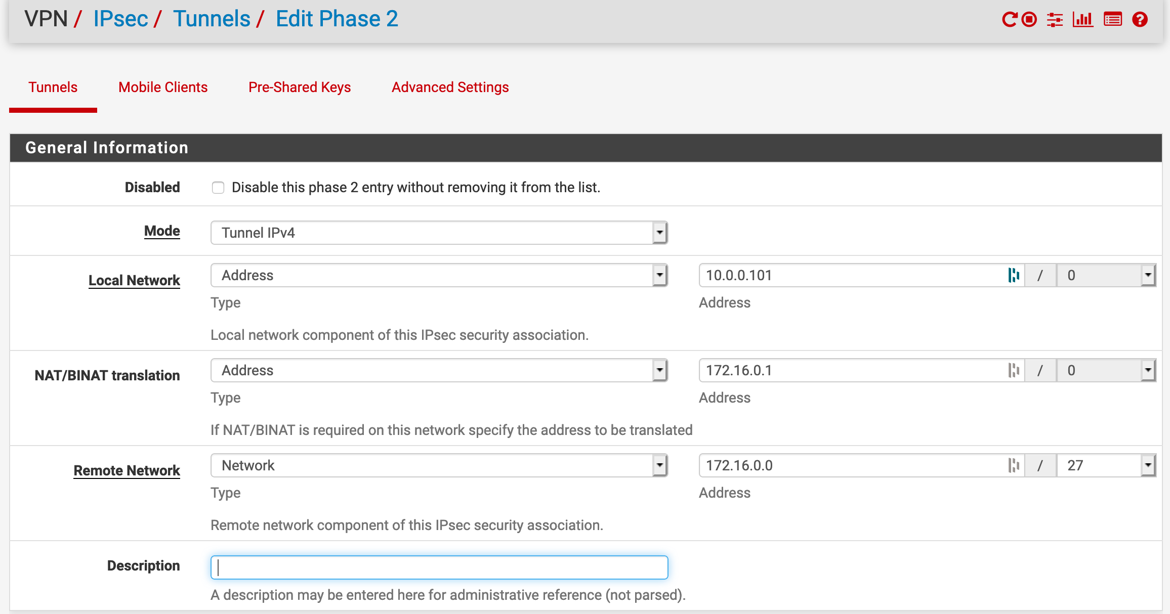

      On one side, I have a (Site A - 10.0.0.1/24.) PFsense connected with a site-to-site IPSEC tunnel. Site B is on 172.16.0.0/27 and has a few machines that need to get their traffic forwarded/pushed to specific devices on the other side.
      I have multiple phase 2 connections so that the 1:1 is done there.
      Right now I have firewall rules set up so everything from 172.16.0.1 should get sent to 10.0.0.101 (which is set up as a gateway).
      The goal is to have all traffic from 172.16.0.1 be forwarded to 10.0.0.101. Just trying to confirm this setup should work.
