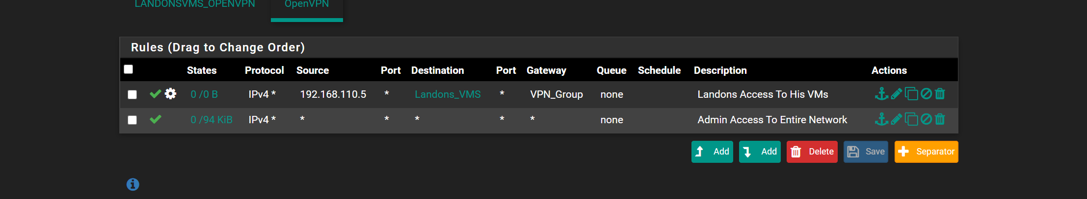

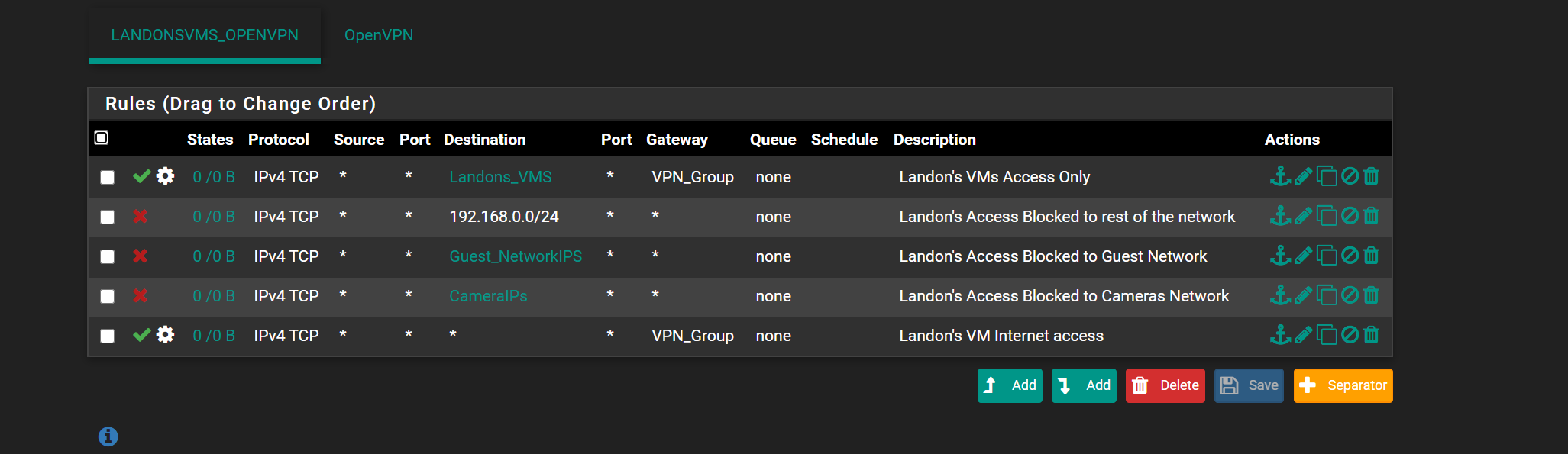

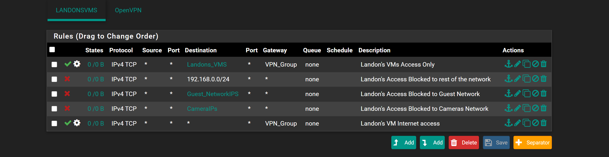

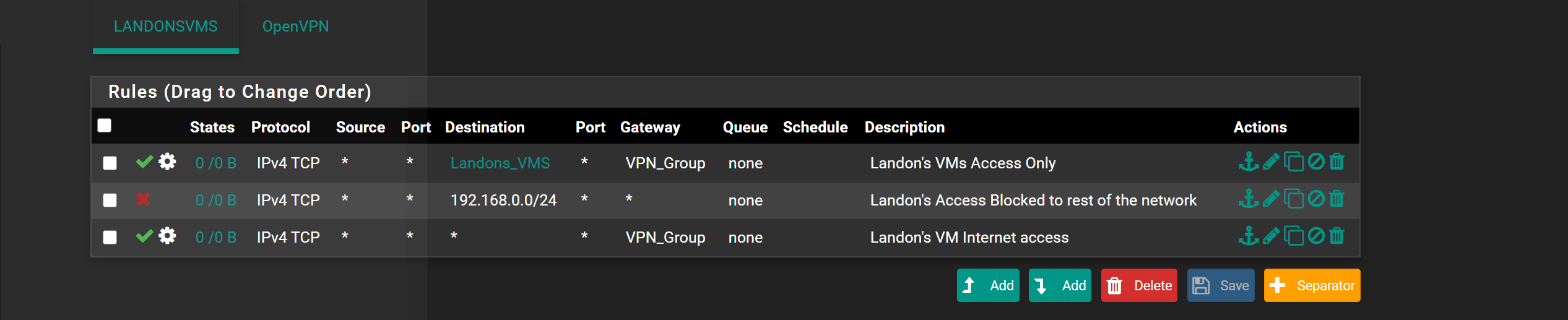

                      comet424

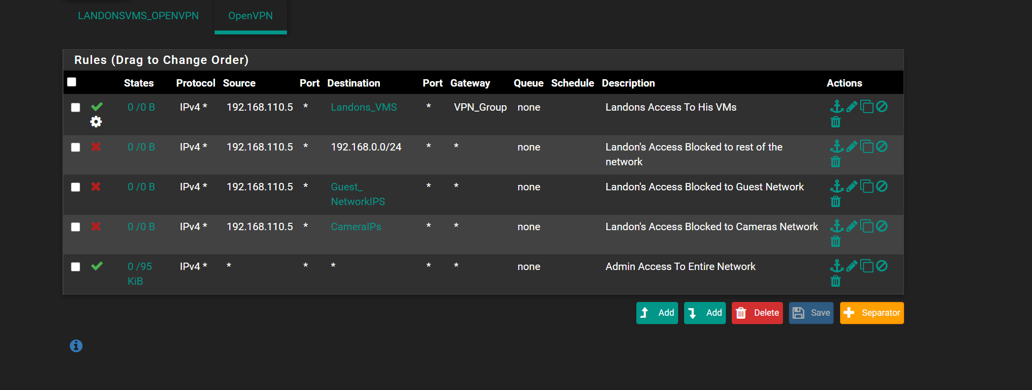

                      update..
                      here is i added blocks for the 10.x 20.x as i havent set them up yet dont have guests or cameras yet.. just future for over winterlandon.PNG
                        akuma1x @comet424
                        @comet424 The firewall rules in pfsense work from the top to the bottom on an interface, the first rule to match wins, no other rules are evaluated.
                        To setup your block rule for 10.x.20.x, you would simply create a new rule with that as the destination, and either an alias with your source IP addresses, or a specific IP address on that same subnet, or some other network on your pfsense box.
                        The rule @Gertjan used above blocks all other devices except the 0.10 - 0.15 hosts. Then, after you create this rule, drag it to an appropriate spot in your firewall list and do some testing.

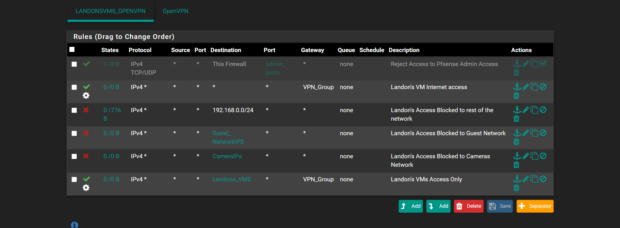

                            comet424
                            @akuma1x
                            this is my LAN rules i think i have it set properly then

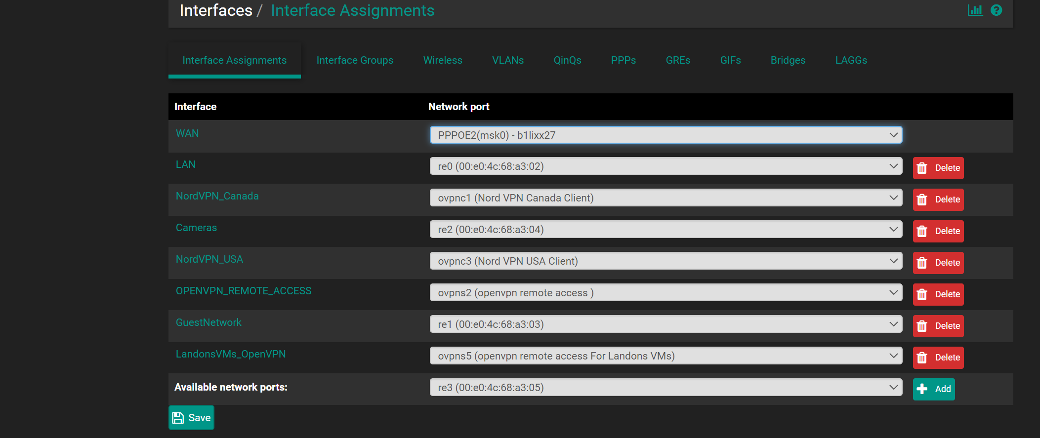

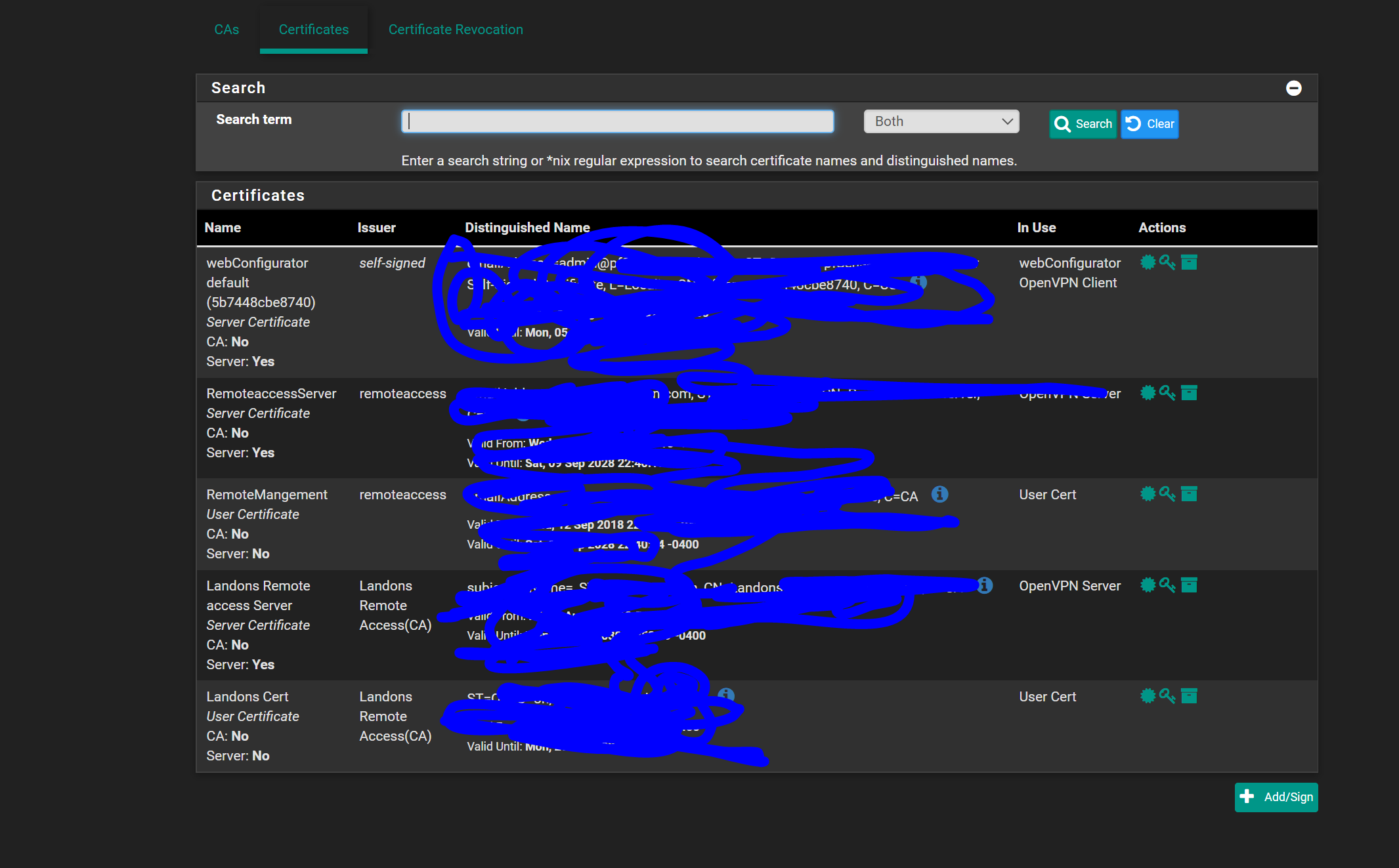

                                    i come across another issue with the openvpn to make that 2nd openvpn i did the wizard where you create a new cert new ca i did the 192.168.0.0/24 etc i chose the assignment and gave that openvpnvm link... but when i goto to Export the clients are not shown.. its there for the main one i have for full access
                                    so i get "If a client is missing from the list it is likely due to a CA mismatch between the OpenVPN server instance and the client certificate, the client certificate does not exist on this firewall, or a user certificate is not associated with a user when local database authentication is enabled."
                                    now today first time running 2 openvpn servers and its been a year since i even touched my openvpn server since i set it and forget it.. and dont work with this everyday..
                                    i did the wizard but what could gone wrong.. where would i look what screen shots would you need

                                        figured it out had to choose user and the bottom the certs linked and had to link exisit cert... now i can test it at home depot lol
                                        hopefully it all works (:

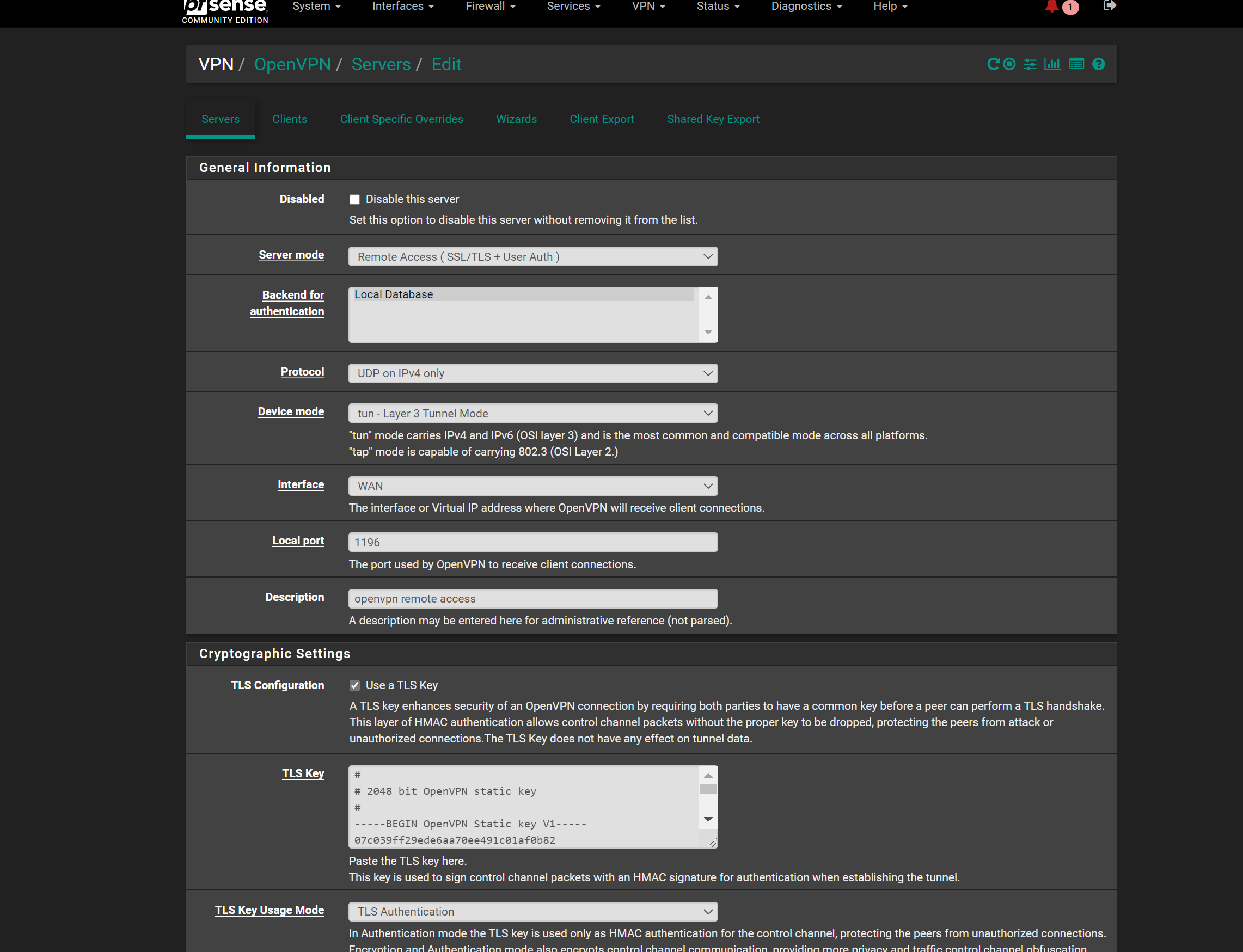

                                          ok so i cant seem to connect,,, i was able to connect to my orginal openvpn
                                          the 2nd one with my other account its stuck on connecting.. i was able to download the opvn file but when connecting its jus stuck connecting... is there something to check.. i checked that it was basiclly exactly same as the admin one i have setup and i did run the wizard.. but its stuck at connecting.... even if i make up a user using the client software it stays connecting.. if i make up a user on my orginal open vpn it tells me invalid
                                          so its not getting to authenticating or what not

                                            so i got it to log in using the landon account i had to delete the user and re add it then create cert button instead of add cert and then add exisiting cert..

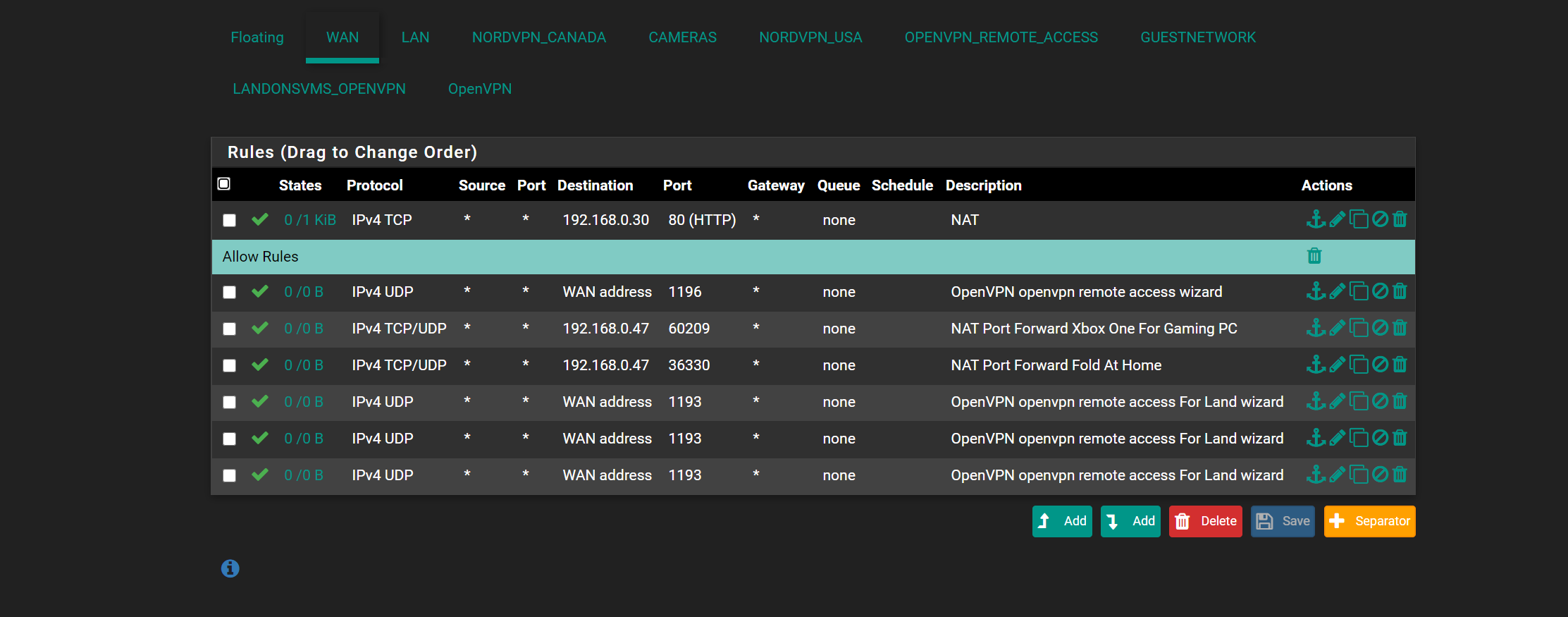

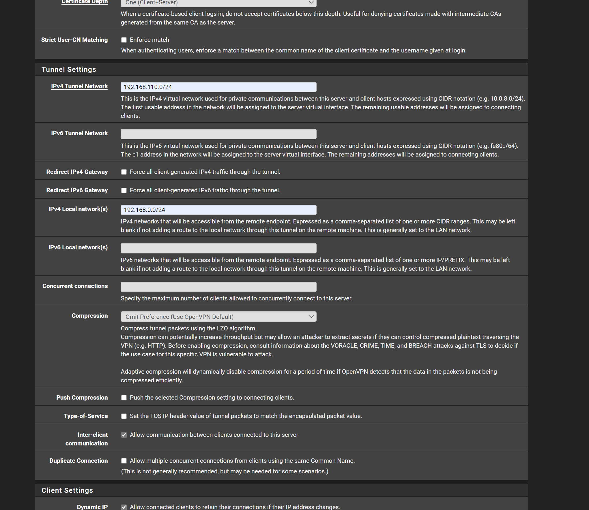

                                            but there is issue.. i was getting full access to the network.. so when i got home.. LandonsVM Open VPN didnt get really access.. but it went to the OPENVPN Firewall rules.. it didnt go to the correct firewall rule.. where do i look
                                            also everytime i delete the openvpn server, certs,ca, and do the wizard again.. it always saves the rule under OPENVPN not the LandonsVMOpenVPN..
                                            but interface is set for it so its going to the wrong firewall rule
                                            what do i look for that its going to the wrong rules?
                                            interfaces
                                            rules
