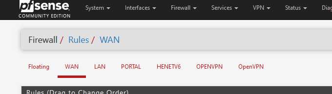

                    What is this :
                    @NasKar said in Lose DNS when OpenVPN Client is turned on.:
                    My VPN_WAN Rules
                    Your WAN interface ?
                    The OpenVPN interface ?
                    These are mine :
                    N 1 Reply Last reply
                    Reply Quote 0
