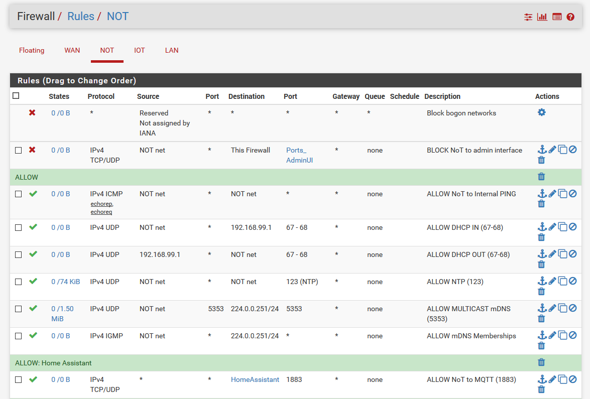

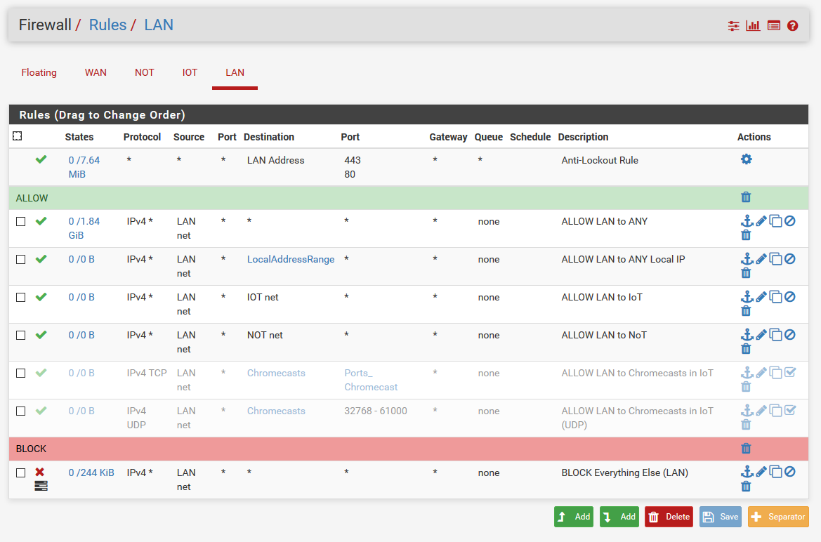

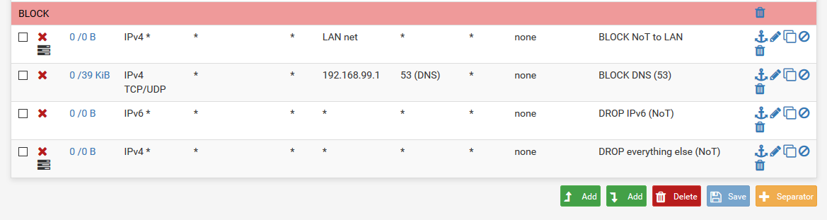

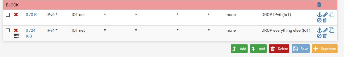

      Quite often an issue with traffic to device on another vlan, is firewall on that dest device. Or that device not using pfsense as its gateway.

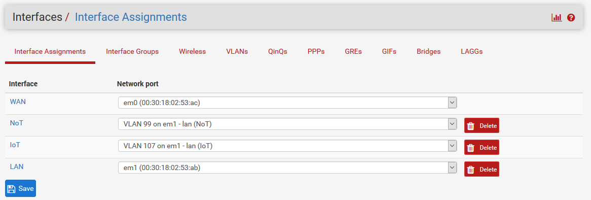

      I would suggest you update your drawings to show your current setup - because this was clearly borked.
      If would suggest you sniff on your dest vlan interface on pfsense - do you see the traffic being sent. What do you get in response? If anything?
      edit: Also why would you be blocking bogon on a lan side interface? How would there ever be bogon on your own network?

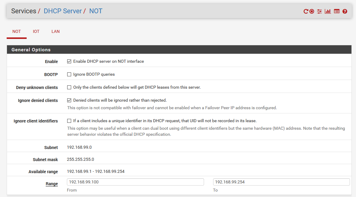

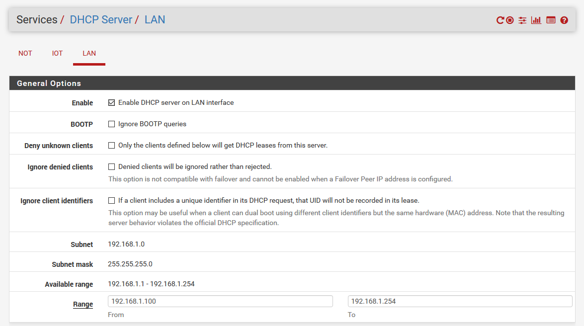

      Why are you allowing dhcp? There is no need for that - pfsense auto adds rules for dhcp wheen you enable dhcp or dhcp relay on an interface.. There is no need for such rules.

            @johnpoz said in VLAN Routing with UniFi APs:
            Hmm ... Didn't know that šŸ‘
