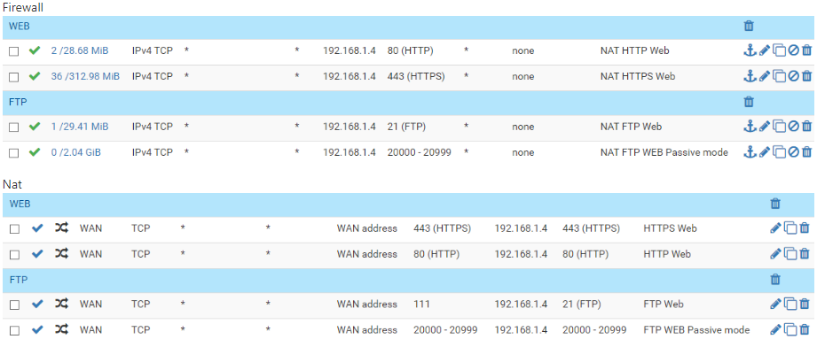

I am trying to make some commands works like openssl, netcat, and some others due to some tools requirement.
But when i try thoose command i get a timeout.I feel like PFSense is cutting the connexion (no answer => timeout) for security reason because External IP domain doesn't match internal domain (in my configuration the same IP as multiples domains)
When i try the command from PFsense i can have an extra message:
DNS fwd/rev mismatch: domain.ltd != domain1.ltdNetwork configuration
In LAN
When i try the following command it works from "Any client"nc -v 192.168.1.4 443 Connection to 192.168.1.4 443 port [tcp/https] succeeded!When i try the following commands it fails from "Any client"
nc -v externalIP 443 nc: connect to externalIP port 443 (tcp) failed: Connection timed outnc -v domain1.ltd 443 nc: connect to externalIP port 443 (tcp) failed: Connection timed outPinging domain1.ltd is working from "Any client"
External network
nc -v domain1.ltd 443 Connection to domain1.ltd 443 port [tcp/https] succeeded! nc -v domain1.ltd 80 Connection to domain1.ltd 80 port [tcp/http] succeeded!PFSense Configuration
NAT Reflexion is on : Use system default
If you have any idea on what i am doing wrong it would really help me.
Thanks.

It looks like it was mostly covered in the other thread but:
https://docs.netgate.com/pfsense/en/latest/nat/accessing-port-forwards-from-local-networks.html
thanks for the link !
It seems to work now (at least for netcat), i ll make some more test
PS: I confirm all my current needs are working !
Yeah with Pure NAT mode and auto-outbound NAT you avoid asymmetry. It should work.
