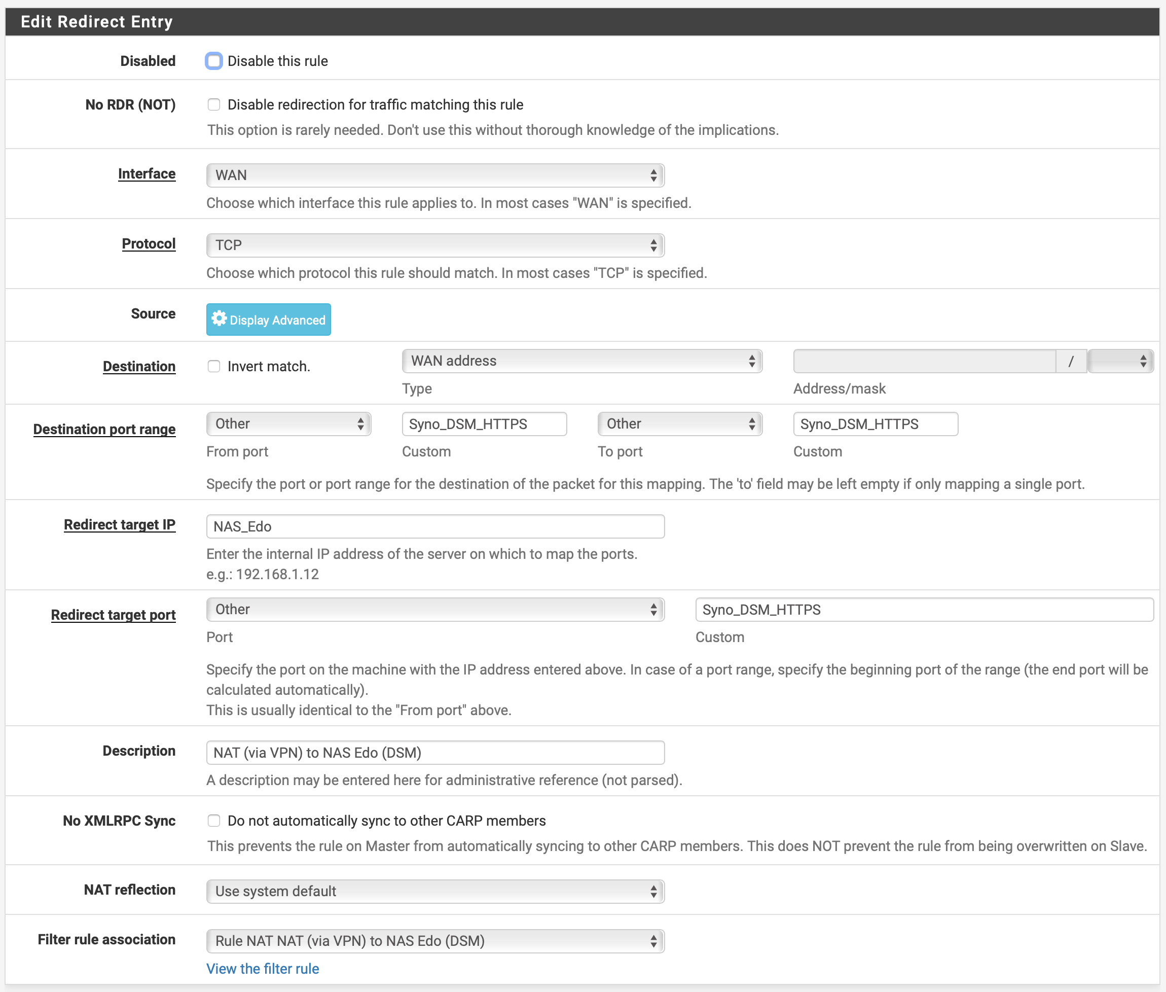

      Now I need to access directly a resource on Site 1 (a port of the NAS) from the internet, using the public IP of Site 2.
      So, I've created a NAT rule on Site 2 to forward the needed port to the private IP of the NAS on Site 1.

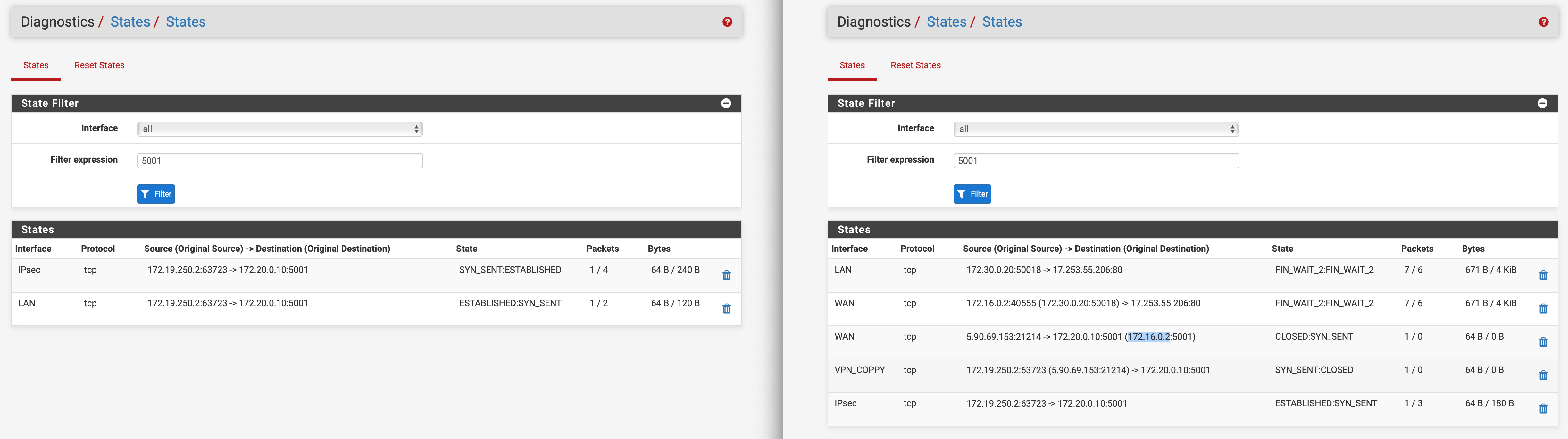

      The setup seems to work and the NAS in Site 1 receives the connection (from the right IP), but the response did not leave the firewall on Site 1.
      No blocked connection are listed in the firewall logs, and this is the States view from both sides (Site 1 on left and Site 2 on right).

      This is the port forward rule:

          I have the same issue on my setup but in my case Site 2 does receive the return traffic, it just doesn't translate the destination IP of the return traffic back to the original source IP (the public IP) so the return traffic stops at the Site 2 IPsec interface. I switched from OpenVPN to IPsec because I needed the speed bump so OpenVPN is not a solution for me. Any workarounds to this?
