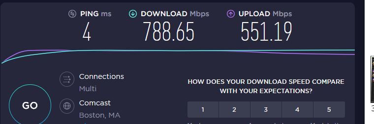

      Hi, I have gig speed internet and when I run a speed test the graph only hits 100 meg but the test speed is 800mb up 770 down, I cant find where to change this if there is a way?

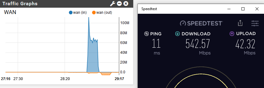

        Could you post a image of exactly what your seeing.. I don't see such behavior, and there is not really a way to set the scale in the graph I am thinking of.
        I don't have gig, but a 500/50 connection - but you can see the graph is showing correctly

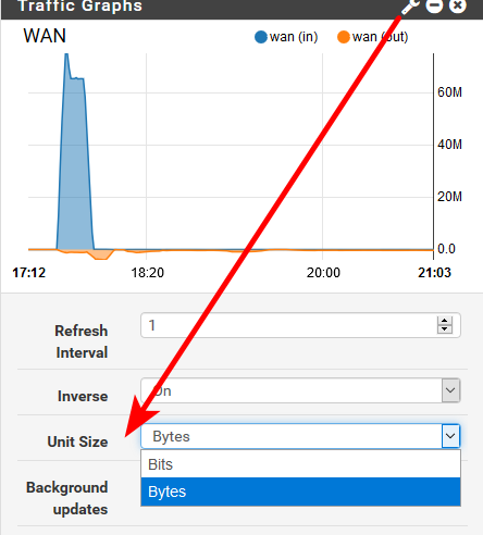

          This setting? I think it defaults to Bytes on install.

            That would be the widget setting.. Yeah that can be set to bits or bytes.

              ![alt text](lanwan.JPG speedtest.JPG image url)
                Yeah check your bits/Bytes setting..As @provels stated.
                There are 8 bits to the Byte - so doing rough math 788Mbits per sec /8 is right around 100MBytes per second.. so your showing Bytes vs Bits.
                Nice upload by the way - would love to have that..
                The amount of smoothing can have a impact to what is shown as well.. But 542/8 = 67.75
