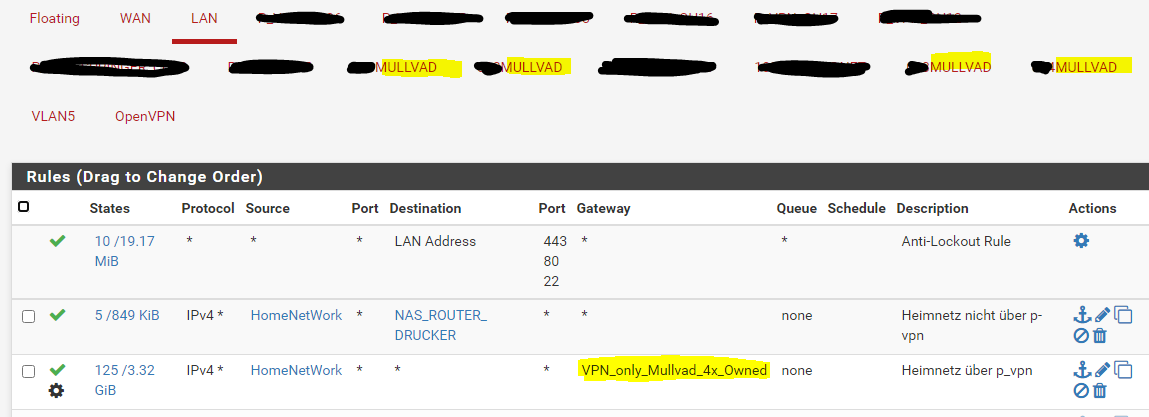

          What i did not understand was what you have suggested with the printscreen of the firewall rules:
          I guess that you suggested with that printscreen that i should add a rule for each VPN-Interface to route the traffic explicit through my loadbalanced WAN-Gateway Group or what was your suggestion?

            @ihrewerbung "What i did not understand was what you have suggested with the printscreen of the firewall rules:
            I guess that you suggested with that printscreen that i should add a rule for each VPN-Interface to route the traffic explicit through my loadbalanced WAN-Gateway Group or what was your suggestion?"
            YES ๐Ÿ˜‰
            I use multi-port NICs (I350-T4 and I350-F4) so I can have VPNs on a separate interface and handle them separately according to firewall rules
            ++++edit:
            this is good for the deep network segmentation
            I 2 Replies Last reply Reply Quote 1

              Thank you for your fast reply. Now I perfectly understand this with your suggestion (I use multi-port NICs (I350-T4 and I350-F4) so I can have VPNs on a separate interface and handle them separately according to firewall rules). I must admit that I never thought about that but now i see some potential for optimazing!
