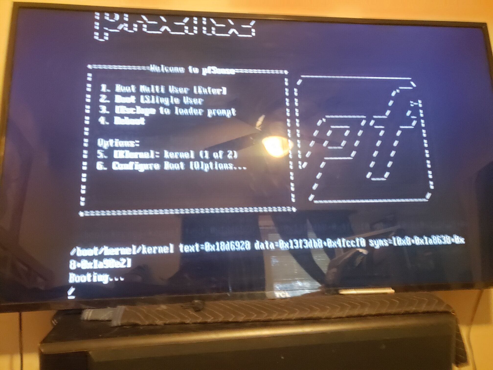

      I have a protectli fw10001 appliance that used to work fine with pfsense. It stopped booting after I continuously unplugged it without properly powering it down. I then went to install Pfsense again on it and it will not boot into the install prompt of OS for that matter. It will however load up ubuntu properly and boot fine with ubuntu.. It is PFSENSE that is freezing upon bootup. I am loading it VIA USB image I downloaded online. Any help would be very much appreciated. Thank you in advance for your help.

              ok so here is what I am doing to burn image. i download the USB VERSION of ETCHER on a windows 10 box and I use Etcher to burn image to USB. It seems to start booting image and gives me the initial boot menu. Then it JUST HANGS on boot. Attached are the pics of where it hangs when it bootsrsz_20201017_173241.jpg

                    So I just now tried RUFUS as well. I also burned an image with WIN32IMAGER all 3 booted and then just HANGED when it got to same Booting... message as in picture above. I have installed this many many many times and have never had this kind of issue before. ETCHER, RUFUS AND WIN32IMAGER all 3 I have used to burn image. Any other suggestions would be greatly appreciated.
