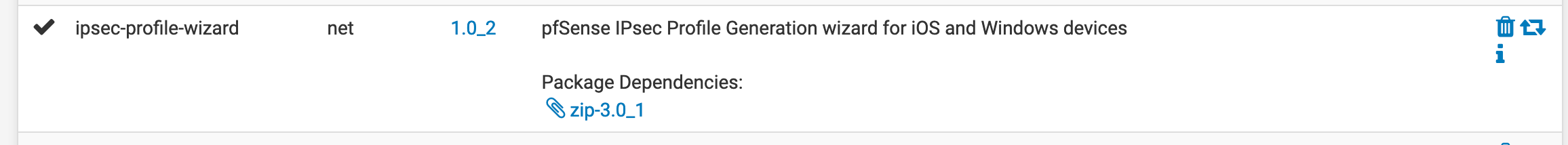

      I have two SG-2100s but IPSec menus are different. They have exactly same version of software. Is there someone to know what difference is?

        You need to install this factory package:

          jauintm
          Thank you so much!

            Did you restore a configuration to the second one that was from a different device?
            Those packages (ipsec-profile-wizard and aws-wizard) should be present in the default installation, but if you restore a configuration that didn't have the packages, they would have been removed.
