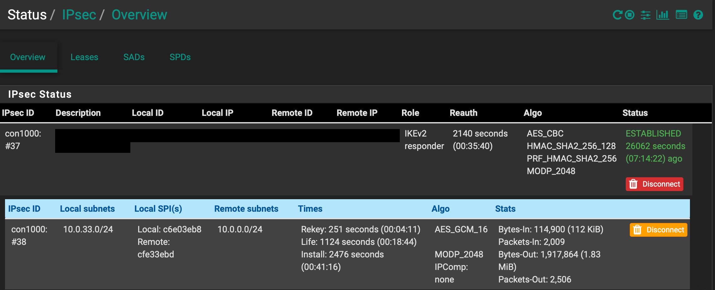

      Setup a IPsec site-to-site both locations can access local LAN resources on the other.

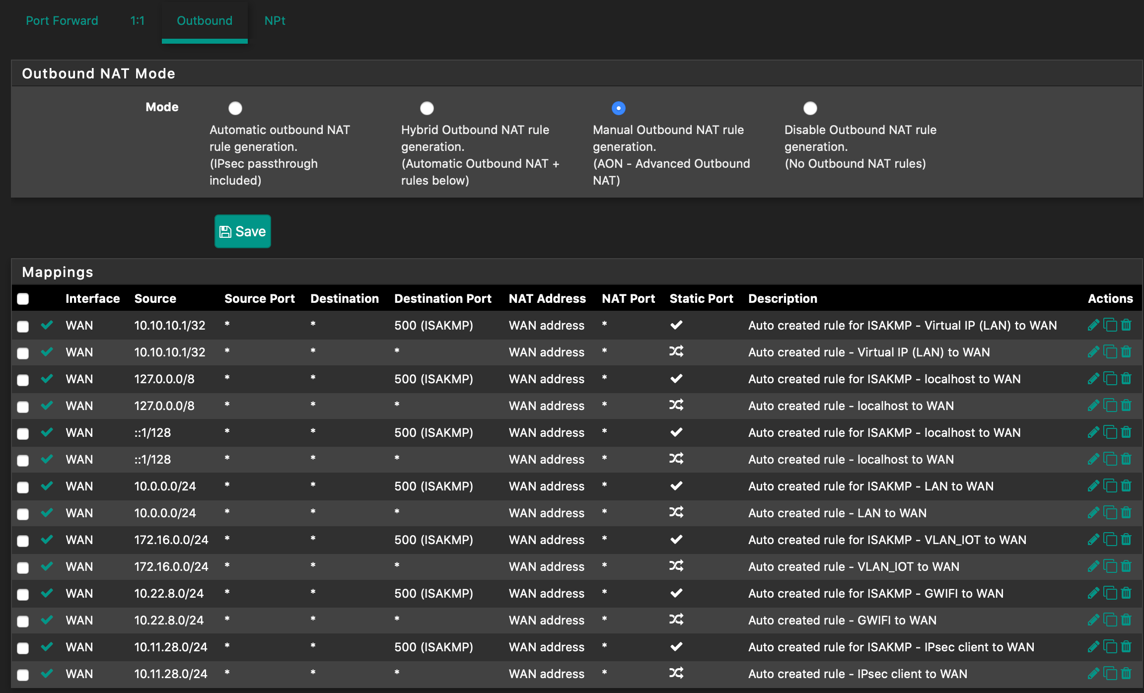

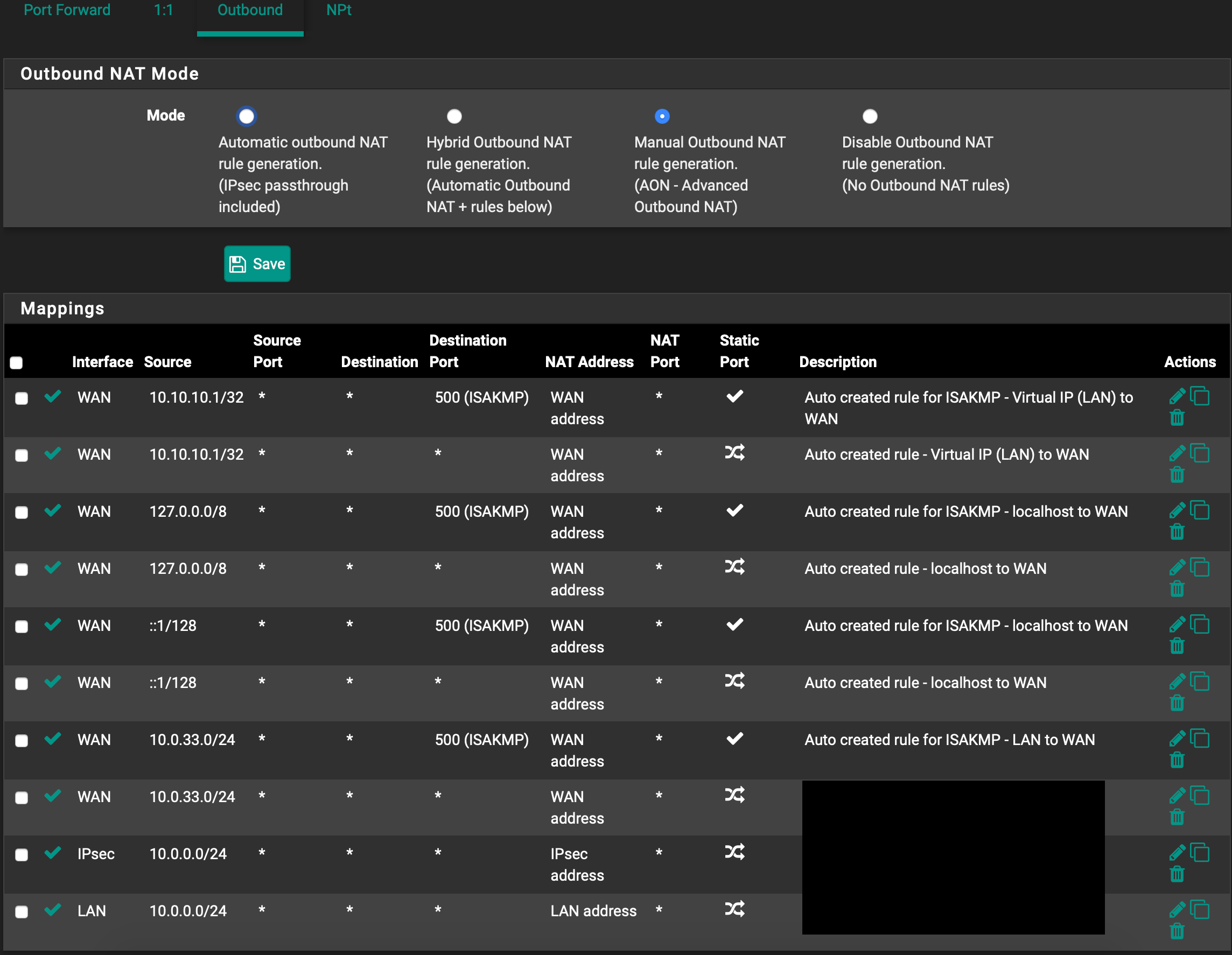

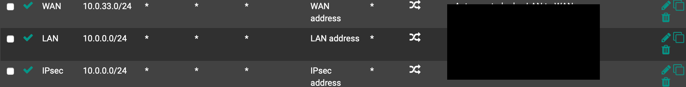

      Unsure what I am missing tried to add outbound Nat on site2
      Outbound NAT on site 2 for the site 1 network
      I am flexible in how to get this to work long as I can route traffic from client in site 1 over gateway in Site 2

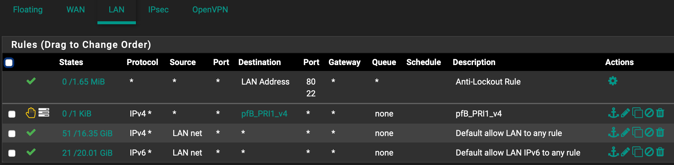

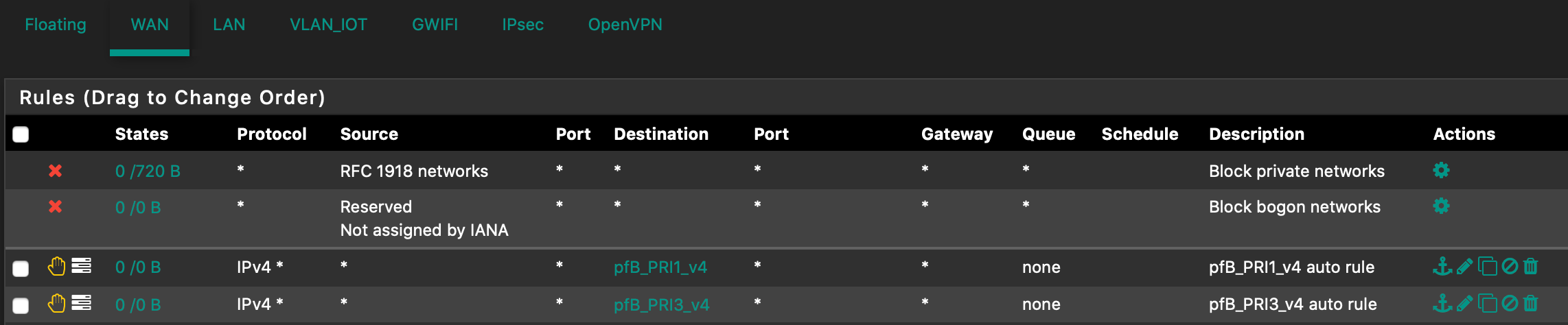

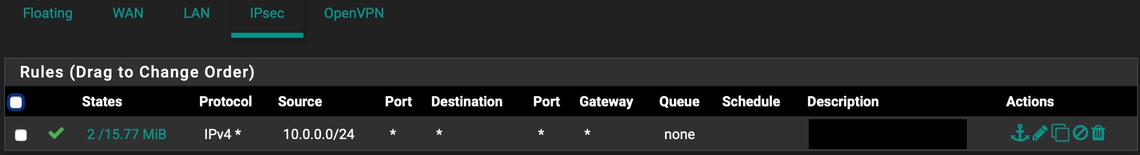

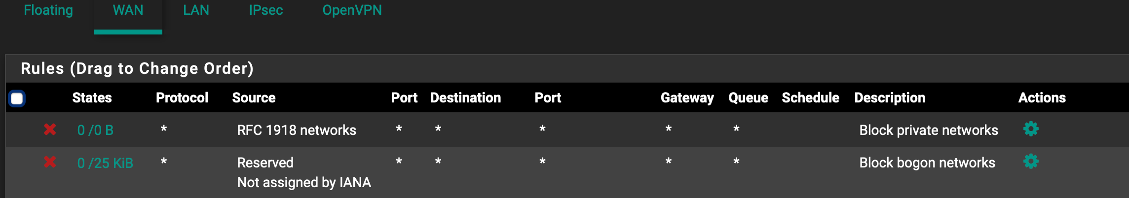

      Setup on Site 2

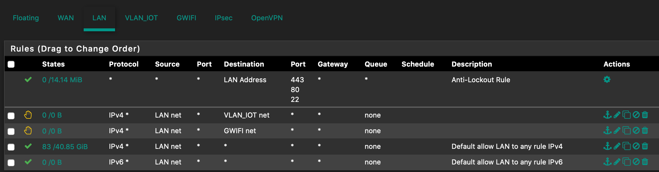

      Setup on Site 1
