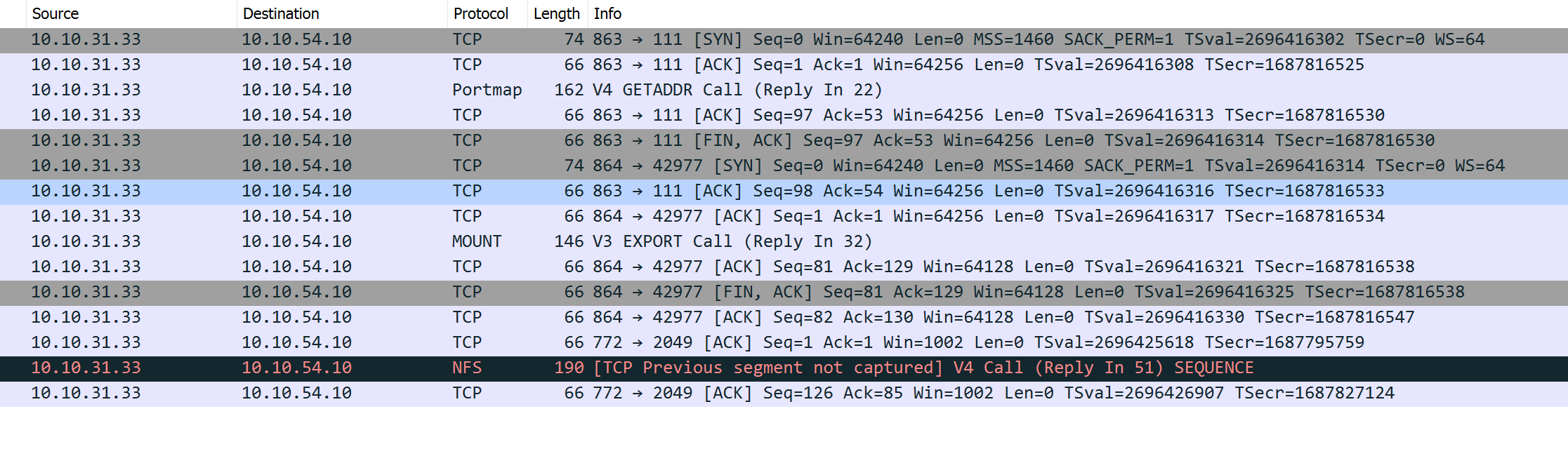

      When I have a rule allowing VLAN1 > VLAN2 allow TCP/UPD on 111 and 2049 it does not work (those are the two ports needed)
      You can see from the sniff below that it negotiates a higher port and then works when I have the any<>any rule.

      Working version with any>any

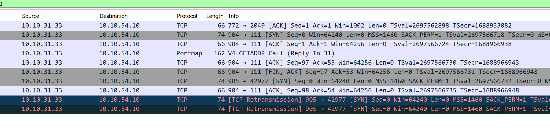

      Non-working version

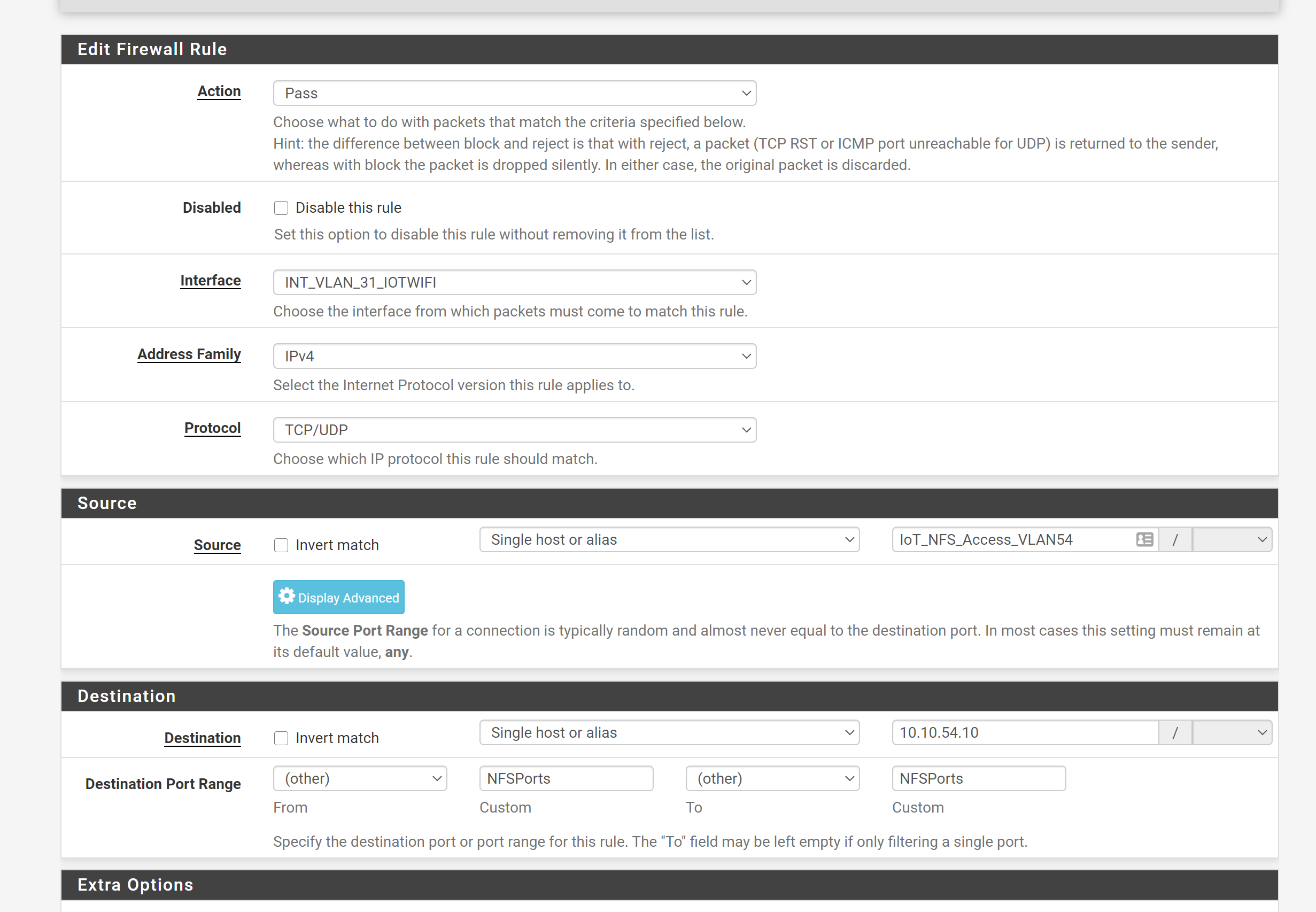

      The rule:
      NFSPorts Alias
      Should the upper port be auto-negotiated or something like that?
      • kiokomanK Offline
        kiokoman LAYER 8
        you also need mountd port
        under ubuntu it's
        sudo nano /etc/default/nfs-kernel-server
        RPCMOUNTDOPTS="--port 12345"
        sudo systemctl restart nfs-kernel-server
        rpcinfo -p | grep "tcp.*mountd"
        open port 12345 on pfsense
