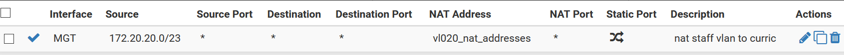

      I am trying to get our VLANs talking to our local LAN and the internet at large. I have setup an outgoing NAT on my local LAN interface with an IP pool. However, I can't get any traffic working using the IP Pool. It will work, however, if I NAT to the interface address.
      The setup is as follows.
      The MGT interface is currently acting as my local LAN interface.
      MGT interface IP address is x.x.x.61.

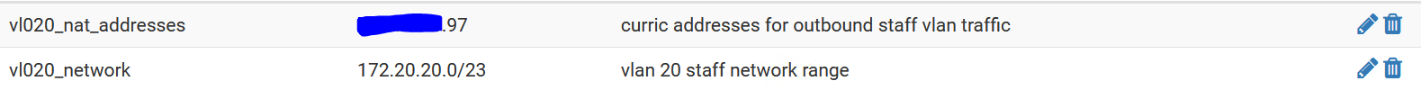

      For testing, the single "pool" address is x.x.x.97. This is registered as a host alias
      Outbound NAT mode is hybrid.
      The outbound NAT rule is as follows
      The aliases I have setup are
      With the NAT Address set to vl020_nat_addresses I can't get any outbound traffic happening. With the NAT Address set to "Interface Address" it does work. pool options are set to "Round Robin with sticky".

          thanks for the response. I have since discovered my problem, it seems the IP address I picked was in use elsewhere on the network (undocumented of course). Once I picked a free IP address it's all working as I had expected.
