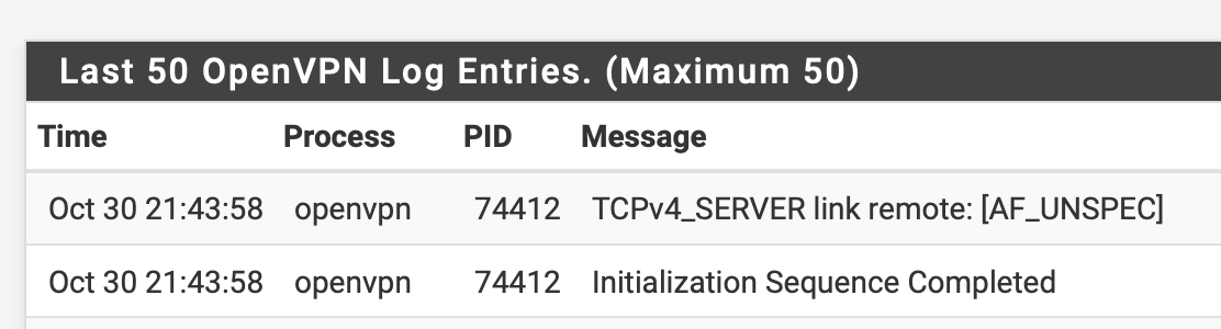

          DominikHoffmann
          It’s as though the client can’t get through to the server at all.

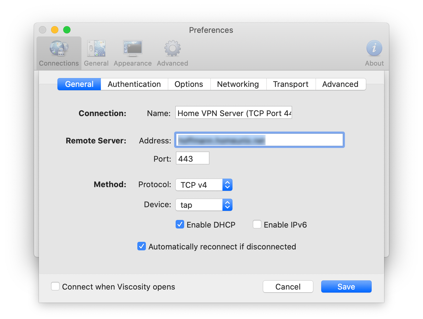

              Here is the configuration screen of the Viscosity client:

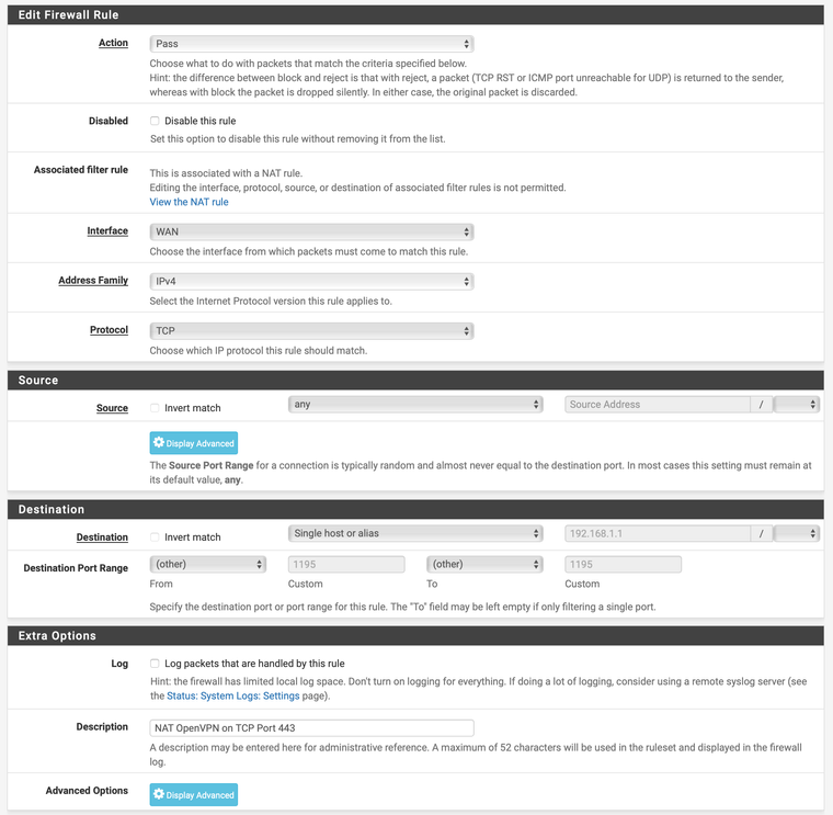

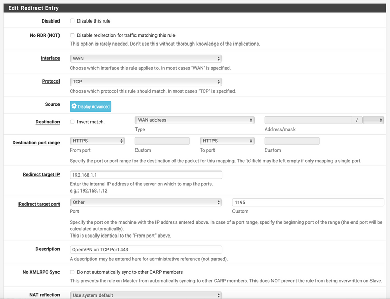

                DominikHoffmann @DominikHoffmann
                Here are my NAT and Firewall rules:
                Those have not changed since I first had gotten this all to work.

                      Gertjan
                      Why redirecting to 192.168.1.1 ?
                      Isn't 192.168.1.1 (the LAN of) pfSense ?

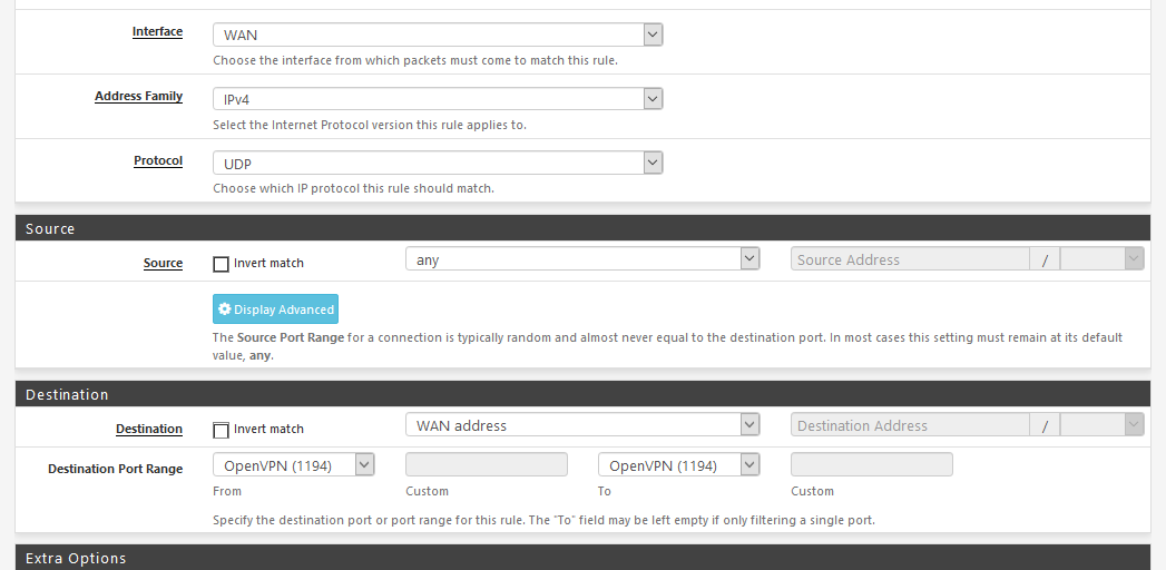

                      OpenVPN, as it listens also on the WAN interface of pfSense, doesn't need a NAT rule, just a firewall pass rule :
                      Interface WAN
                      Port 443
                      Protocol TCP.
                      See the default firewall when you activate OpenVPN using the wizard the first time :
                      ( you've changed UDP for TCP, and 1194 for 443).
                      443 port is already used by another service : the GIUI web server, if you have https GUI access activated. If so, move it to another port.
                      If you have a router in front of pfSense : check if a NAT rule on that device still works.
