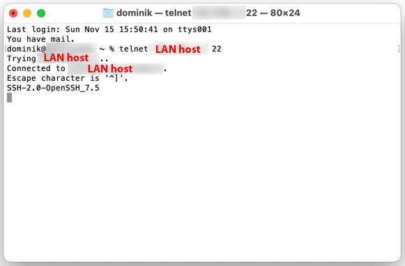

      When I am on the LAN I can telnet into that host (on Port 22) like so:

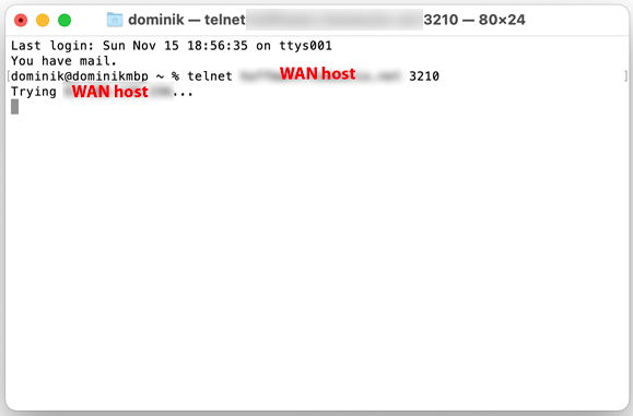

      However, when I am outside of my home, I cannot get in:
      Crickets!
      Where else might there be a block? My ISP is not blocking anything, which I verified today.

        Your mentionned a ssh acces, but are using telnet.
        What happens when you use 'ssh' ?
        Why do you hide LAN IP addresses ?
        Your firewall rule is on WAN ?
        Then this :
        says a lot : nothing comes into the pfSense WAN port.
        This means : traffic is blocked up stream. Most typically your upstream ISP router. That one has to be natted to.
        edit : the pfSense manual contains a complete run down on how to look for NAT and port forward issues.

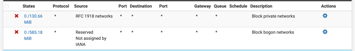

            These are the only preceding firewall rules:
            I will get back in touch with my ISP. My ISP doesn’t provide its own router. Their hand-off is the Ethernet port of their ONT (optical network terminal).
              And those rules are seeing quite a few hits.. 585MB to bogon??? WTF??

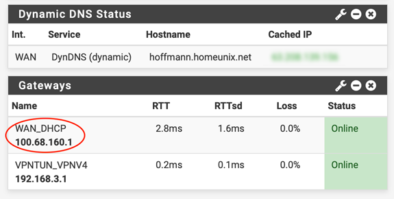

                                @johnpoz: I guess, I was not familiar with did not fully understand exactly what everything on the pfSense dashboard meant.
                                If I had understood, I would have noticed that the IP on the Internet (obscured, green) was not identical to the WAN_DHCP address (circled in red).
                                My ISP has given me a static IP address, and everything works now, including my OpenVPN setup about which I had posted earlier. I am still trying to ascertain, why it worked in the first place.
                                Thanks very much for all of you who helped shed light on the issue.
                                  Or just that 100.68 is a Carrier grade nat IP.. 10.64/10
                                  Well how it worked in the first place, is when it was working you were not on a CGNat IP..
