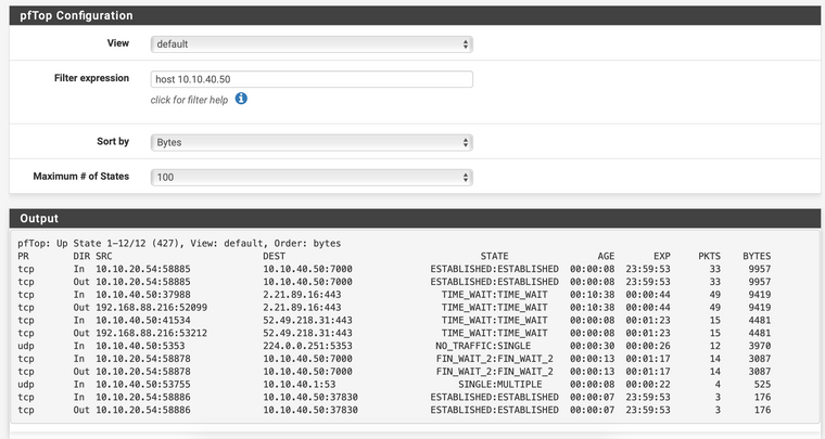

      I can discover the LG TV on my Office VLAN (Avahi is working). When I establish a screensharing session I can see in pfTop a connection "ESTABLISHED: ESTABLISHED" between my laptop (10.10.20.54) and the LG TV (10.10.40.50)

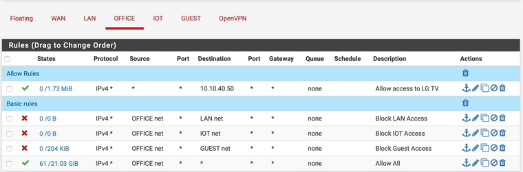

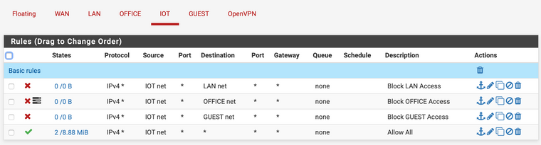

      But, the screensharing is blocked by my FW rule, that blocks access to Office and other VLANs.
      Firewall Rules
      These rules are in place to prevent traffic to flow between VLANS. Maybe there is a better way. FYI. my WAN address is part of RFC1918 range.

      As you can see, then there is an established connection form my laptop (10.10.20.54) to the LG TV (10.10.40.50)

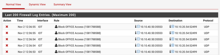

      And unfortunately then the session is blocked by my FW rule. If I disable this rule, then it works. But I thought that if the connection is initiated by 10.10.20.54 (Office) then 10.10.40.50 (IoT) would be allowed to respond on any port.

        As it's UDP, there's no concept of a "session" - the TV is sending packets to the office LAN that are correctly being blocked based upon your rules

              @logboss Not in a ideal way with specific miracast ports. I simply assigned the TV a static IP and added Allow rule from TV to Office Net and from the Office Net to the TV. So not they can communicate on all ports to TV IP.
              Not great, but it works :-)
