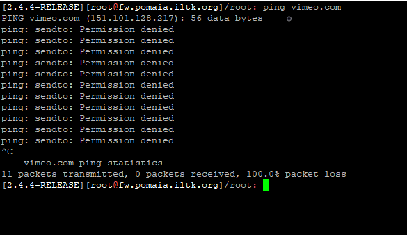

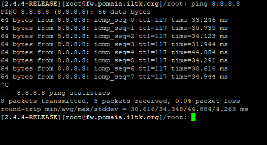

                • E Offline
                  EmanueleILTK
                  from shell of firewall server
                  the problem suddenly appears from nothing, was working perfectly fine till two days ago, but sometimes the site it's working
                  if it was related to the rules of the firewall it would have never worked

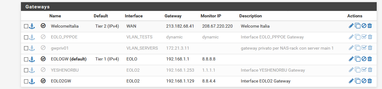

                      Are you using vip on your wan? Did you wan IP change? Can you ping loopback? 127.0.0.1, when this happens.. Your saying that you can not ping just this IP, but every other IP works 1.1.1.1, 4.2.2.2 (other public dns).. Other sites works.. So you can ping say www.netgate.com, but then not vimeo.com, and then www.cnn.com works?
                      This is hardware pfsense, this is not a virtual instance of pfsense?
                      Lets see your routing table? Do you have more than one gateway setup for pfsense?
                      Your not running any sort of IPS, like snort or suricata.. In your log do you see the firewall rules reloaded or loading?

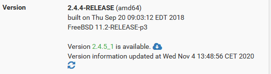

                      • Raffi_R Offline
                        Raffi_ @EmanueleILTK
                        @EmanueleILTK said in Can't no access to some websites:
                        I have pfsense version 2.4.5_1
                        The first post states the latest version but your CLI prompt says 2.4.4. Is it a VM which is swapping between versions?

                            • E Offline
                              EmanueleILTK
                              @Raffi_ said in Can't no access to some websites:
                              sorry, i have the 2.4.4 version
                              i have 3 wan, the problem is in all of them,
                              This is hardware pfsense, i dont use a VIP
                                Upgrade. You're not even on 2.4.4p3.

                                    I really don't know what to do, do you advise me to update the system?

                                      default 192.168.1.1 UGS re0
                                      dns.google 192.168.1.129 UGHS re2
                                      Well from that.. looks like your sending traffic to google or 8.8.8.8 out a different gateway then what your normal gateway (default) is.

                                      So if you can still ping google, but not other stuff.. Points to an issue with your normal gateway.

                                          this is my getways
                                          • johnpozJ Online
                                            And since your using a different gateway for 8.8.8.8 and it works, but something to normal gateway fails.. It shows an issue with your default gateway..
                                            Again what does your log say... If your having issues with a gateway it should be logged..
