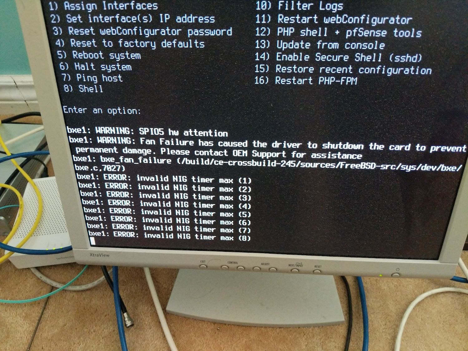

      one of the fans on my 10G NIC is making an ugly sound, so i replaced it. Now because the new fan spins slower than the original one the driver is not liking the tach signal, so my mom of a NIC driver yells at me with the following error:
      ![0_1604792851494_fan err.jpg](Uploading 100%)
      Error trace:
      bxe1: Warning: SPIO5 hw attention
      bxe1 Warning: Fan Failure on Network Controller has caused the driver to shutdown the card to prevent permanent damage.  Please contact OEM Support for assistance
      bxe1: bxe_fan_failure (build/ce-crossbuild-245/sources/Free-BSD-srd/sys/dev/bxe/bxe.c,7027)
      So my question is: Given that we are a loose cannon that does not play by the rules, and are willing to accept any consequence when the router explodes, is there a way for us to turn off this annoying error? Or is this a FreeBSD thing and we need to recompile the aforementioned driver and somehow get FreeBSD to make use of that instead?

        ***photo didn't upload for some reason.

          Hmm, looks like it's hard coded, there is no tunable to prevent that:
          https://github.com/pfsense/FreeBSD-src/blob/RELENG_2_4_5/sys/dev/bxe/bxe.c#L7026
