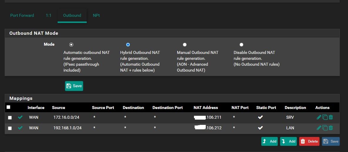

              How do we go about making internal traffic from one of our servers orgininate from the public IP it is assigned?
              eg.
              server 1 - public 1
              server 2 - public 2
              server 3 - public 3 etc.
              I've not understood how to ensure server 3 when it connects to external services it appears to come from its public 3 IP addresss? - hope this makes sense.
              • kiokomanK Offline
                kiokoman LAYER 8
                uhm yes, the video does not show that part anyway it's really easy,
                you just need an outbound rule, like this
                • E Offline
                  EngineerSB
                  I see, so the source can be the entire net or I guess the specific IP of the internal server?
                  • kiokomanK Offline
                    kiokoman LAYER 8
                    yes, I have only one server inside that network so I didn't care to set a /32 but you can do that
