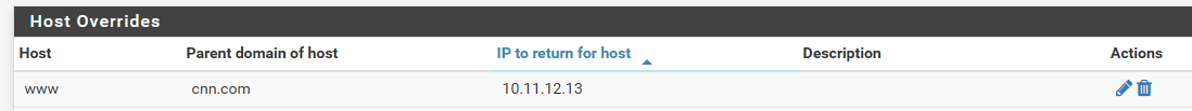

                Here I setup a host override for www.cnn.com to point to 10.11.12.13
                If I query that locally - that is what I get.

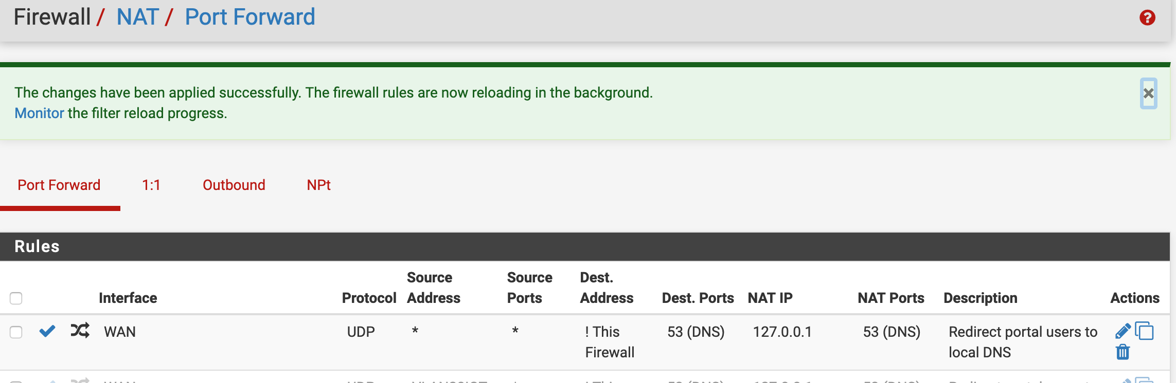

                              • K Offline
                                kevdog @johnpoz
                                @johnpoz
                                Bubble burst
                                I'm assuming this is the culprit right here as you suspected
                                  Why would you setup a rule like that - makes zero sense.. For starter why would anything be hitting your wan but not to any of your firewall IPs?
                                  For the life of me - can not figure out what that rule would do.. There should be nothing hitting your wan on 53, but not directed to your wan IP.. What are you wan firewall rules?
                                  But yes if some traffic came into your wan interface for say 8.8.8.8 (not a firewall IP) it would be forwarded to loopback.. If your wan firewall rules allowed it, or some floating rule did. And then yes that would return whatever host override you had setup. etc..
