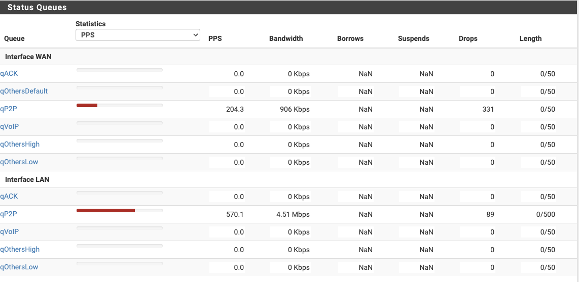

                      charry2014
                      Interesting - Status / Queues shows the following:
                      Also weird the P2P queue is so busy - I can't think of anything that specifically uses that - but none of the other queues ever register traffic.
                      • SteveITSS Offline
                        SteveITS Rebel Alliance
                        qP2P is presumably low priority...
                        I would read through https://docs.netgate.com/pfsense/en/latest/firewall/floating-rules.html, in particular the difference with Quick enabled/disabled.
                        It's possible your P2P rules are picking up some traffic by port number but not all of it. Is it set as your default queue or something? I'm unclear what the top two rules are for, would they not match all upload traffic? In what queue do those put traffic?
                        Upvote ๐Ÿ‘ helpful posts!
                          charry2014
                          Having rebooted pfSense the queues seem to be working fine now, also the call quality with Teams, Slack and Zoom is acceptable. There was a lot of traffic on qP2P as the catch-all option was set. These things are now working fine.
                          A problem with qVoIP remains - during calls with Slack, Teams and Zoom no traffic is routed through this queue. There is no rule in the firewall by the traffic shaper wizard:
                          Any idea why? Do Slack, Teams and Zoom even qualify as 'VoIP' services?
                          • SteveITSS Offline
                            In the shaping wizard there was an option for VoIP and has one enter the remote IPs. Otherwise there's not a great way for pfSense to know what is VoIP traffic. And since you don't know what IPs all of those use it becomes difficult to maintain.
                            One option might be to prioritize all UDP traffic from your device using those services, but there is a caveat noted in the docs, that the shaper works on outgoing traffic and on the WAN (upload) that happens after NAT. So you can't use your private IPs in the rule that applies the outgoing shaping. What you can do is tag the packets from those IPs, and use that tag. https://docs.netgate.com/pfsense/en/latest/trafficshaper/advanced.html#shaper-rule-matching-tips
                            rule with source of your PC IP:
                            rule with source and dest of Any that only applies to the tag, and assigns the queue:
