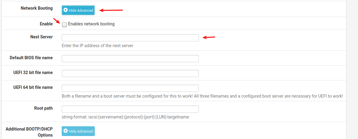

        Do you use isc-dhcpd , as the example indicates ?
        Or would you like to use the pfSense dhcp server to replicate the example shown ?
        It seems a bit unclear , but i have a "gut feeling" that DHCP option 66 and 67 are the ones you want to play with in pfSense.
        Skip the above , there's a full section dedicated to network booting
        /Bingo

        • robert-bergerR Offline
          robert-berger
          Ideally I would like to use only pfsense, but if it's not possible I will need to use an additional DHCP server as well.
          What you are referring to seems to be the "global" settings.
          Services -> DHCP Server
          And this seems to work, but only gives me to option to define "one" next-server, or a series of next-servers globally.
          I would like like so say something like "if the DHCP request comes from MAC xxxx than the next-server is yyyy"
          Services -> DHCP Server -> specific static mapping -> magic
          Correct me if I'm wrong, but with what you suggest I can configure network booting, but I can not dish out "per MAC" next-servers.

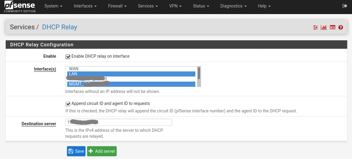

              • bingo600B Offline
                bingo600 @robert-berger
                @robert-berger
                I am using pfSense as DHCP Relay.
                It relays to my Linux ISC-DHCP server(s)
                That way i can use ISC-DHCP syntax on the Linux'es.
                Afaik you can't mix pfSense DHCP Server and DHCP Relay , it's one or the other.
                /Bingo
