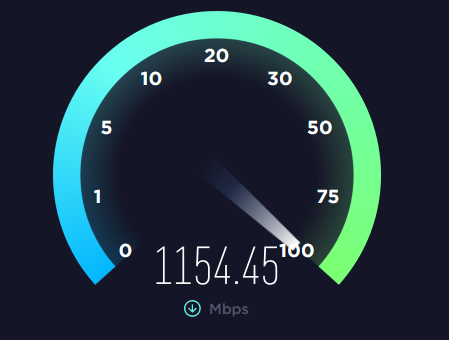

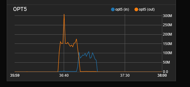

        One more strange thing ive noticed, it seems like the optical connection is working in some capacity on the NAS... if I have the ethernet plugged in to obtain the connection, while leaving the fiber plugged in, and run a speed test... I see some of the traffic is being sent across that port:
        Which aligns with the results because obviously this is impossible for gigabit ethernet...
        I noticed this because in the pfSense dashboard I can see OPT5 (the optical connection) was sending some data across it, up into the mbps range which it shouldnt be if it was just pings or random packets across the network. But if I disconnect the ethernet connection, no more internet connection on that machine.... Im very confused.
