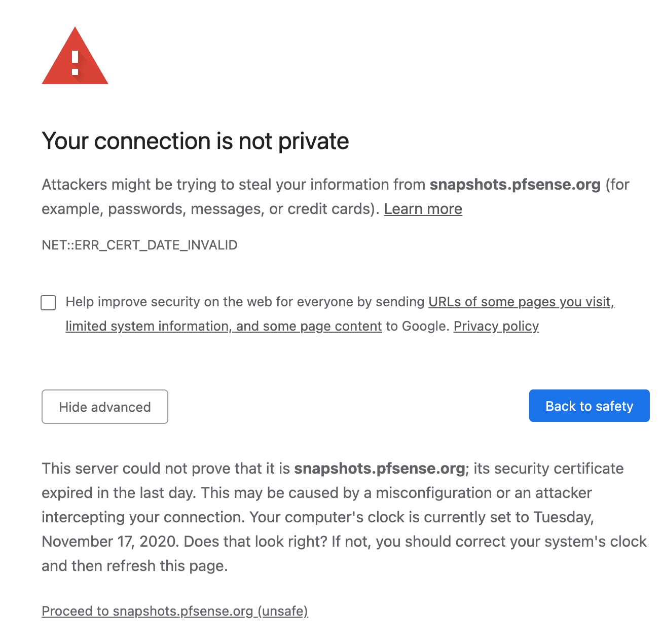

          • O Offline
            Orbixx
            Yup, still using the expired cert.
            • stephenw10S Online
              You might need to refresh that, clear you cache etc. The cert looks OK to me there.
              We are investigating why it would ever have expired though.

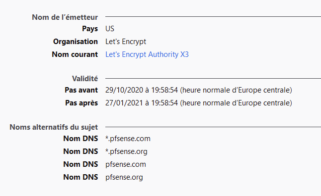

                Gertjan @stephenw10
                @stephenw10 said in Cert expired on snapshots.pfsense.org:
                Because it does so every 90 days (Letsenscrypt).
                This morning, the one in place had timed out at Novembre, 17 - 2020 - somewhere in the morning (local GMT time).
                Now, another one is in place :
                The one in place now (3 hours later) was created 3 weeks ago. Probably the script didn't restart the web server after renewing ๐Ÿ˜Š
                Anyway.
                Case closed.
