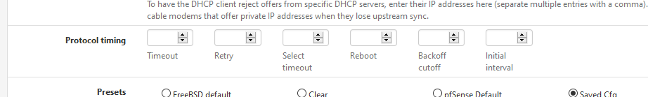

          Checkout out these DHCP Client options (on the WAN interface of pfSense ) : Visit DHCP Client Configuration and check the Advanced Configuration option.
          Now you have these :
          at your disposal.
          The "Reject leases from" is also very usefull.
            at your disposal.
            This looks promising... can you offer any suggestions as to what parameters/values I should configure?
