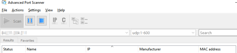

                      Modesty
                      I use Advance port scanner. there is an UDP option, ref screenshot
                      Everything can be rebuilt!
                      chudakC 1 Reply Last reply Reply Quote 0
                      • chudakC Offline
                        chudak @Modesty
                        @Modesty said in Checking for open ports ?:
                        Is it a Windows thing or also for Linux ?
                          Modesty @chudak
                          @chudak windows
