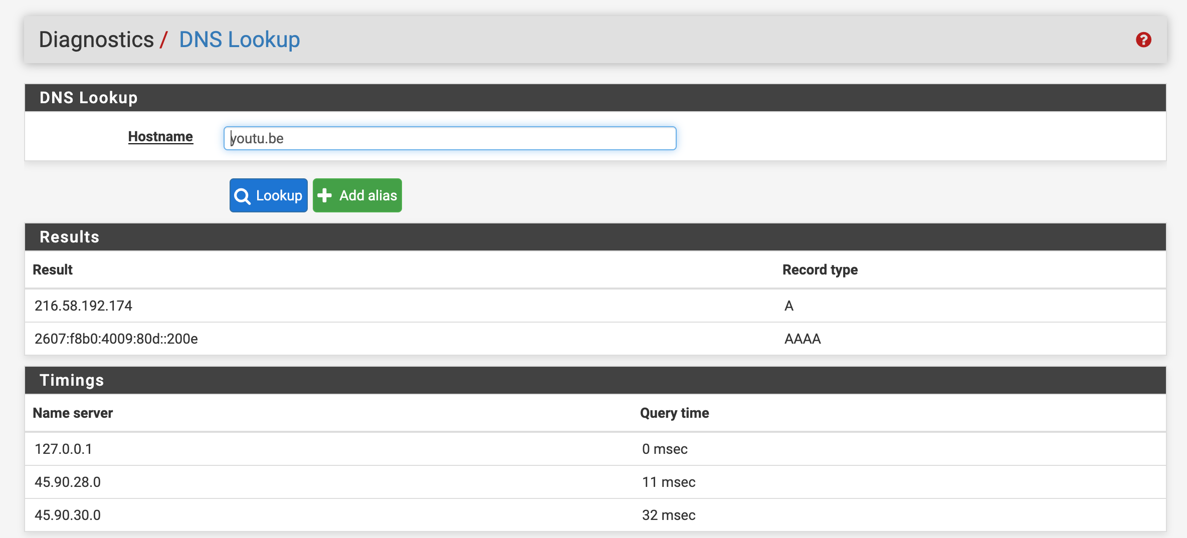

      If I go to Diagnostics > DNS Lookup, it resolves correctly:

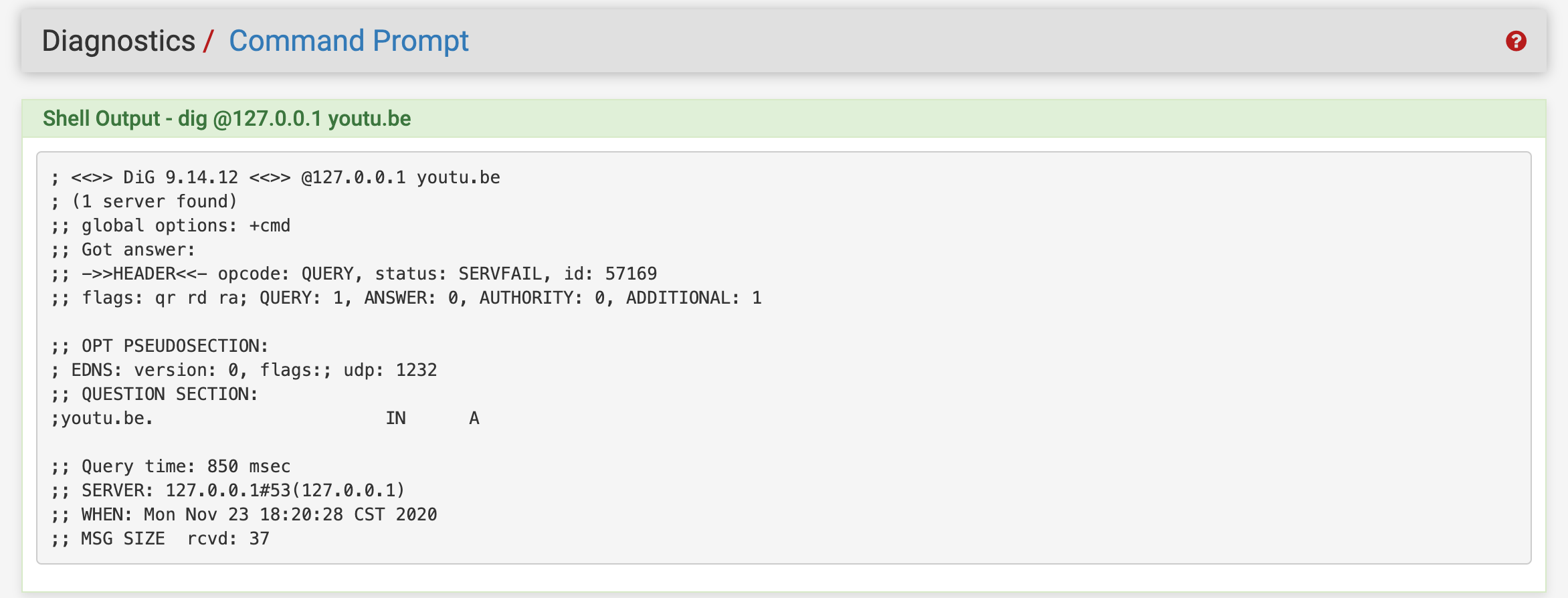

                Well, here's DNS not working from pfsense:
                I do not have pfBlockerNG or any other DNS blockers installed.

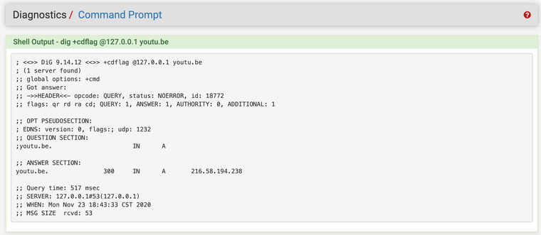

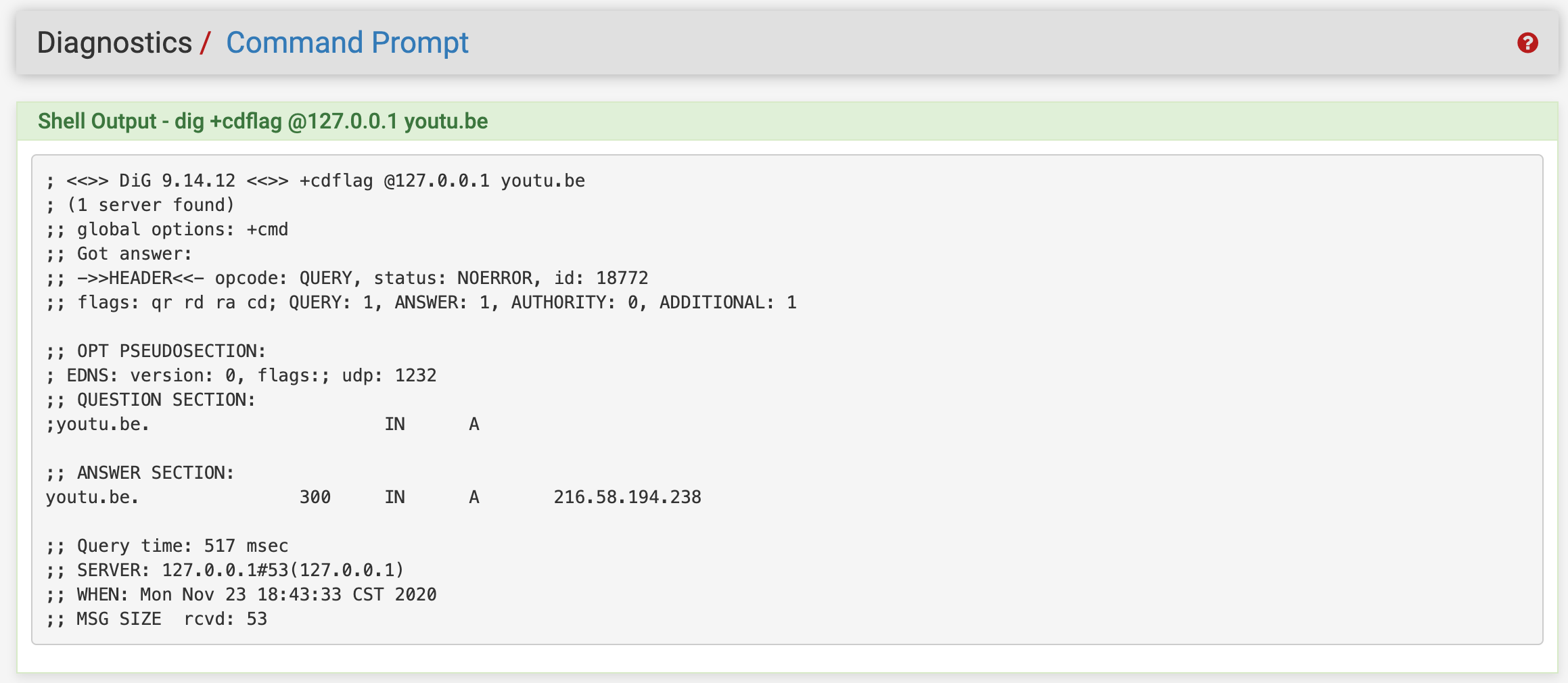

                    Setting +cdflag running dig from pfsense itself works:
                      I would suggest you turn off dnssec in unbound, if your going to forward.. that is what the +cdflag does. nextdns does dnssec, so there is no reason for unbound to be doing anything with dnssec if your going to forward.
