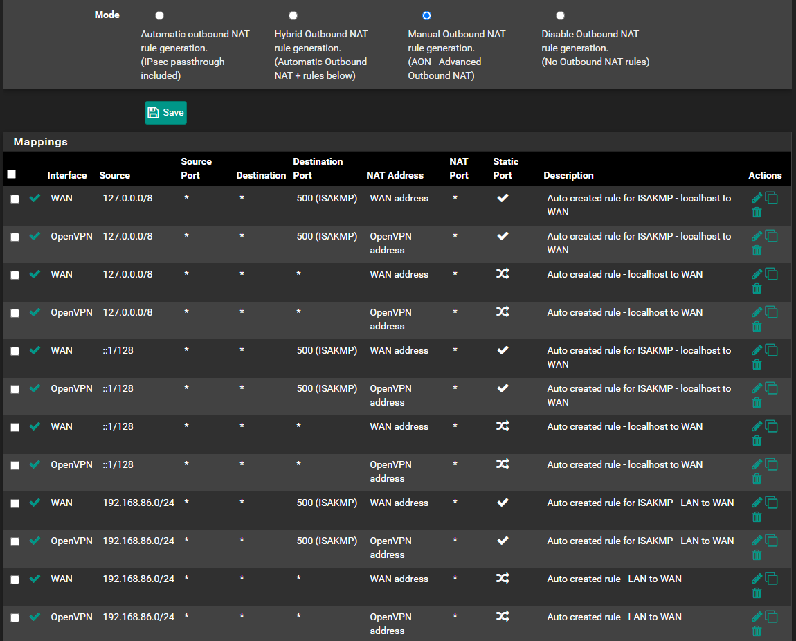

          So I have copied what I assume are autogenerated rules for the WAN interface to setup a couple of OpenVPN clients (screetshot below).
          Is it possible this is the issue? I don't think (or remember) making any changes to the WAN NAT mappings.

              Your Outbound NAT rules look correct though. Assuming your client is in the 192.168.86.0/24 subnet you have a rule with static source ports for port 500.
