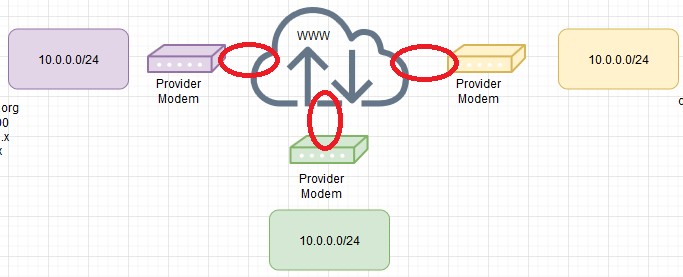

      Ticky homeBrew Situation.
      The Provider Modem only allows to open a port for openVPN (1194 UDP&TCP)
      The pfS Box gets a 10.0.0.0/24 for its WAN-IF. LAN and openVPN IP Ranges can be set at will :)
      The goal is to connect all 3 purple / yellow / green with eacht other.
      The Problem if it is one ... that there is no way (cuz not wanted by the provider) to change the 10.0.0.0/24 range.
      dyndns and an port forwarding for openVPN is working and supported by the ISP (and working afaik)
      before i start wasting time of trying to get a connection road warrior Style and hittin walls, maybe someone can help here pointin some problems to not run into.
      If i m gettin this right, the pfs should set up an on demand openVPN tunnel to another site (purple / grenn / yellow)
      Oh and yes changing the ISP (Provider) is not possible.
      thx in advance

      • RicoR Offline
        Rico LAYER 8 Rebel Alliance
        From your drawing 10.0.0.0/24 looks more like a transfer network and not the WAN IP. The WAN IP would be the red circle.
        As long as you have one site with a Internet routable IP address you can run a hub-and-spoke OpenVPN, for full mesh you need all Sites with a routable IP address.

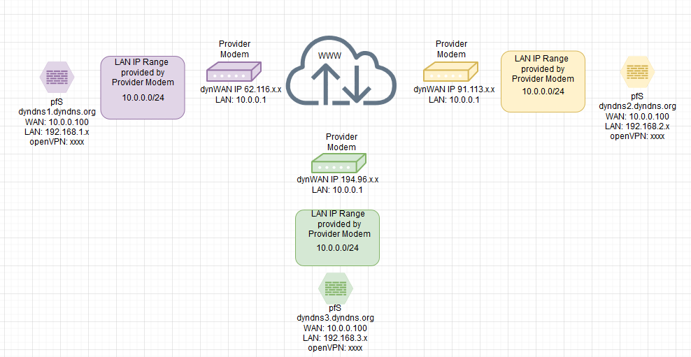

        • noplanN Offline
          noplan @Rico
          @Rico
          i thought that i have to put more info in the grap ... here we go
          each Modem gets a IP from the ISP
          purple ... 62.116.x.y
          yellow ... 91.113.x.y
          green ... 194.96.x.y
          those IPs are gonna change every 8 hours (therefore the dyndns accoounts)
          the pfS box is connected to the modem and receives the 10.0.0.100 (this Range is not changeable, yes it might be possible to get something like purpe .. 10.0.0.10 yellow 10.0.0.20 green 10.0.0.30)
          If I'm gettin you right, as log as my openVPN IP adress Range is differnt for each color (purple yellow green) i wont run into any problems ?
          br NP
          JeGrJ 1 Reply Last reply Reply Quote 1
          • JeGrJ Offline
            JeGr LAYER 8 Moderator
            @noplan said in openVPN different sites same WAN IPs (tricky homeBrew):
            Those 3 statements are normally all you need to have. So to recap that:
            1. WAN IPs are private and set to a 10/8 subnet
            2. LAN can be defined (by you?) so to NOT overlap with each other
            3. OpenVPN is reachable via internet in all 3 locations(?) via port forwarding
            So if you can connect via OpenVPN to all 3 locations correctly AND can define the LANs as per your plan (I'd suggest using more space in between like 192.168.10/20/30.x but OK), that's all you need.
            As long as the 3 pfSense instances can connect to each other in any way you want (star, hub/spoke, any2any...) via a tunnel setup, I see no problem in connecting the 3 locations. As they only communicate via their LAN IP ranges and they are separated from each other, the routing should be fine. And if you set up the ranges more along the CIDR ranges, you can even simplify your routing via OpenVPN further.
            But to give an example: Site A would reach Site B and C via routes 192.168.2.x/24 (ovpns2) and 192.168.3.x/24 (ovpns3) given that both are connected via a site2site tunnel to A. WAN and WAN IP is only interesting in Site2Site tunnel setup but there you'd only have to use the "server" site (e.g. Site A) and perhaps if you'd want direct comms from B to C another tunnel between them.
            Just a small hint at last: use the site with the biggest bandwith as "main site"/server site. If you don't have one really bigger site, take one with static IP. Makes Client->Server site2site VPN setup easier then relying on DynDNS.

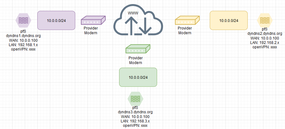

            • RicoR Offline
              Don't put any hosts in one of the 10.0.0.0/24 networks and you'll be fine.

                            • jimpJ Offline
                              As long as you can do DynDNS to the "real" address it's probably fine. Though depending on your budget and throughput needs it might be more stable if you had a hosted/DC/cloud/whatever type server with a static address and then all these dynamic clients connect to that. Then their address changes wouldn't matter. They'd timeout and reconnect in 60s and that's that.
                              Do not Chat/PM for help!
                              noplanN 1 Reply Last reply Reply Quote 1
                              • noplanN Offline
                                noplan @jimp
                                @jimp
                                yes i can get dyndns working with the real IP assigned by the ISP
                                so something like this
                                purple ... 62.116.x.y ... dyndns1.dyndns.org
                                yellow ... 91.113.x.y ... dyndns2.dyndns.org
                                green ... 194.96.x.y ... dyndns3.dyndns.org
                                the budget in COVID times is slim to n00thing
                                thx for the hint with the static IP gonna look into it.
