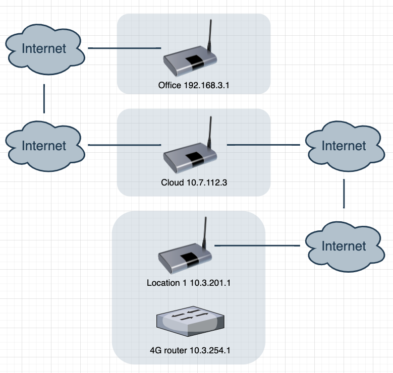

      We have 3 pfsense sides, lets call them office, cloud, location1.
      The cloud is acting as openvpn server and has two connections.
      One from cloud to office and one from cloud to location1.
      On this moment it is possible to connect from office trough cloud to location1.
      So till this point all perfect only now the tricky part.
      Location1 is behind a 4g router, from office we want to access the 4g router for maintenance.
      We did a ping from the cloud pfsense with the openvpn cloud-location1 tunnel as source.
      Then it's possible to ping the 4g router so this is working.
      But when I do a ping from the office pfsense to the 4g router it's not returning any reponse.
      So I assume that something is missing in the tunnel between office and cloud.
      Do you have any tips for me?

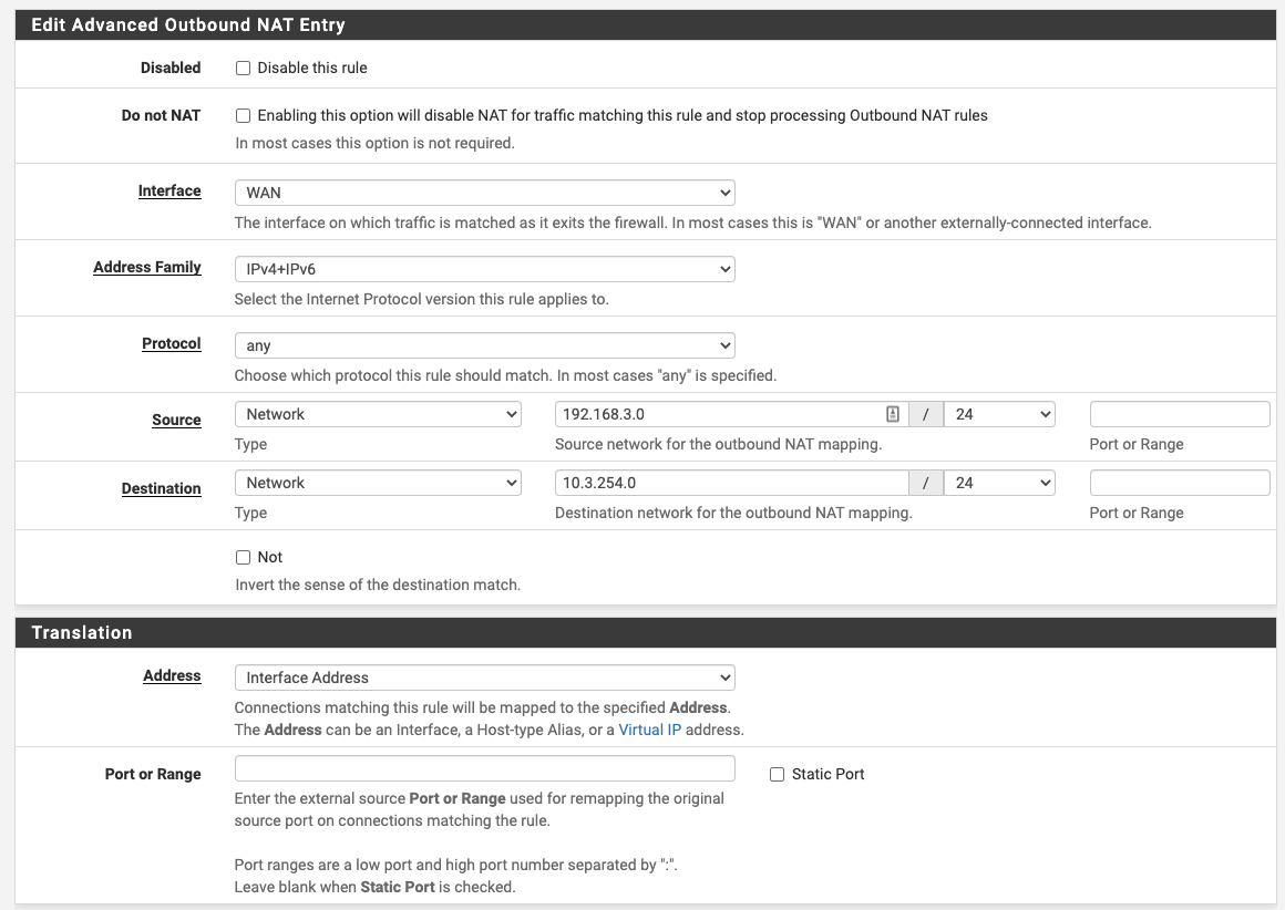

        And add an outbound NAT rule at location 1 to the interface the router is connected to like:
        If the outbound NAT is in automatic mode, switch it to hybrid mode first.
        source: office LAN (where you want to access it from), any if you want.
        destination: the routers IP
        translation: interface address

                  • F Offline
                    Freek_Box
                    So like this?
                    • V Offline
                      viragomann @Freek_Box
                      @Freek_Box
                      At interface you have to select that one which the router is connected to. Don't know, if this is WAN.
                      The other options will be okay.
