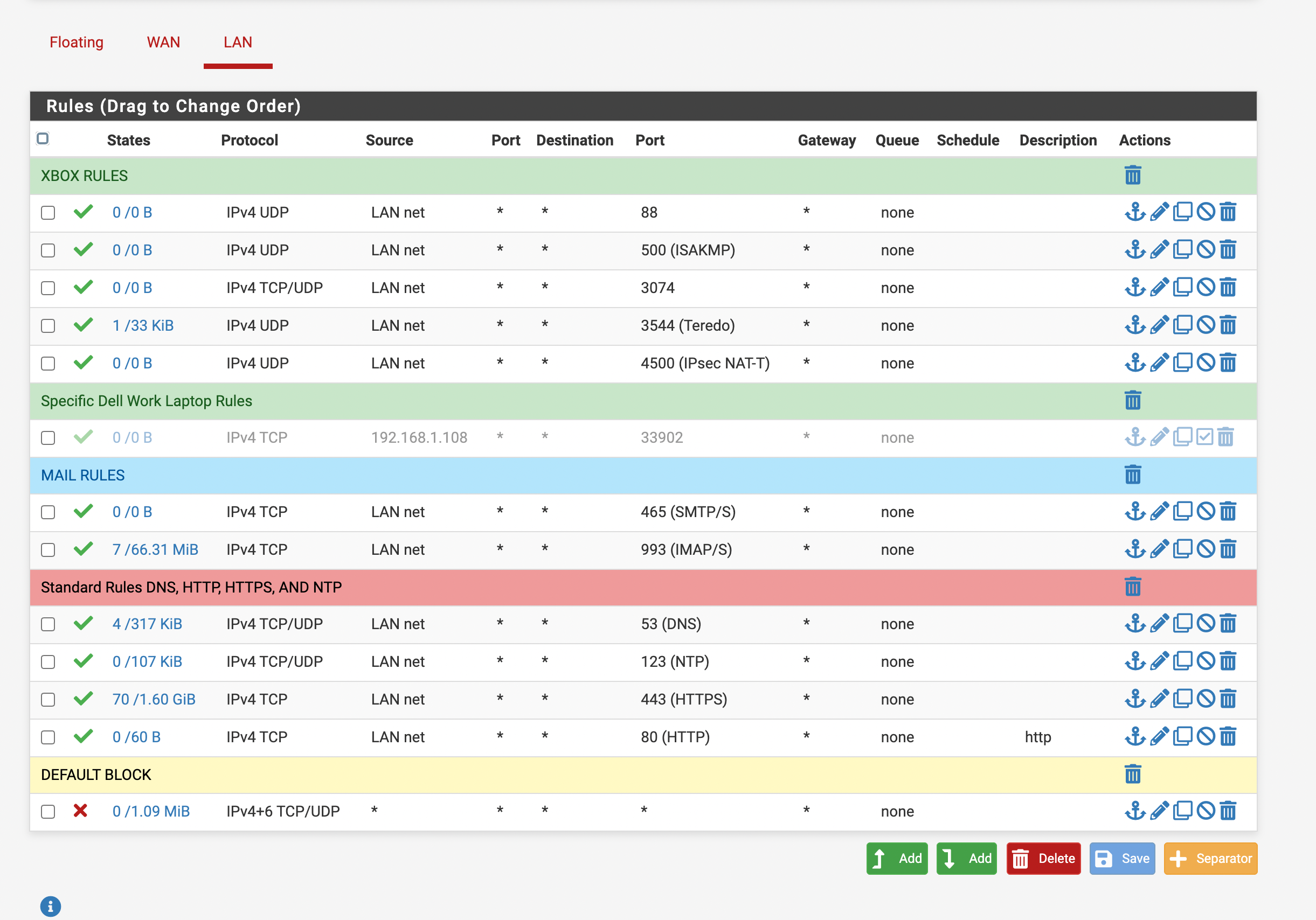

                        • JonathanLeeJ Offline
                          JonathanLee @lfred
                          @lfred
                          Did you enable port 53 for DNS?
                          Domain Name Service it will resolve URLs to IP addresses without it no Internet will work.
                          Here is a copy of my very basic firewall rules. I have DNS set up for anything from Lan can access port 53.
