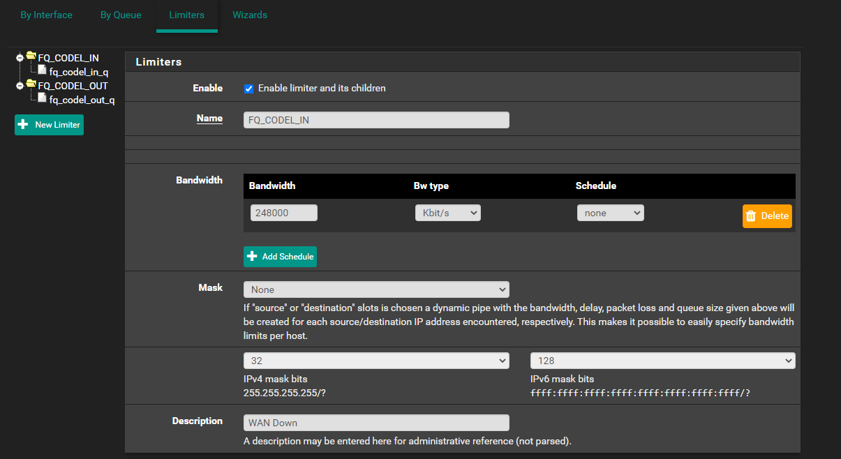

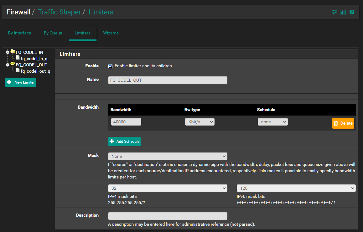

      short question. If I am at full speed, e.g. Download from Steam (292024 Kbps Down / 46718 Kbps Up line).
      The other clients have packet loss or high ping. What can I do against it?

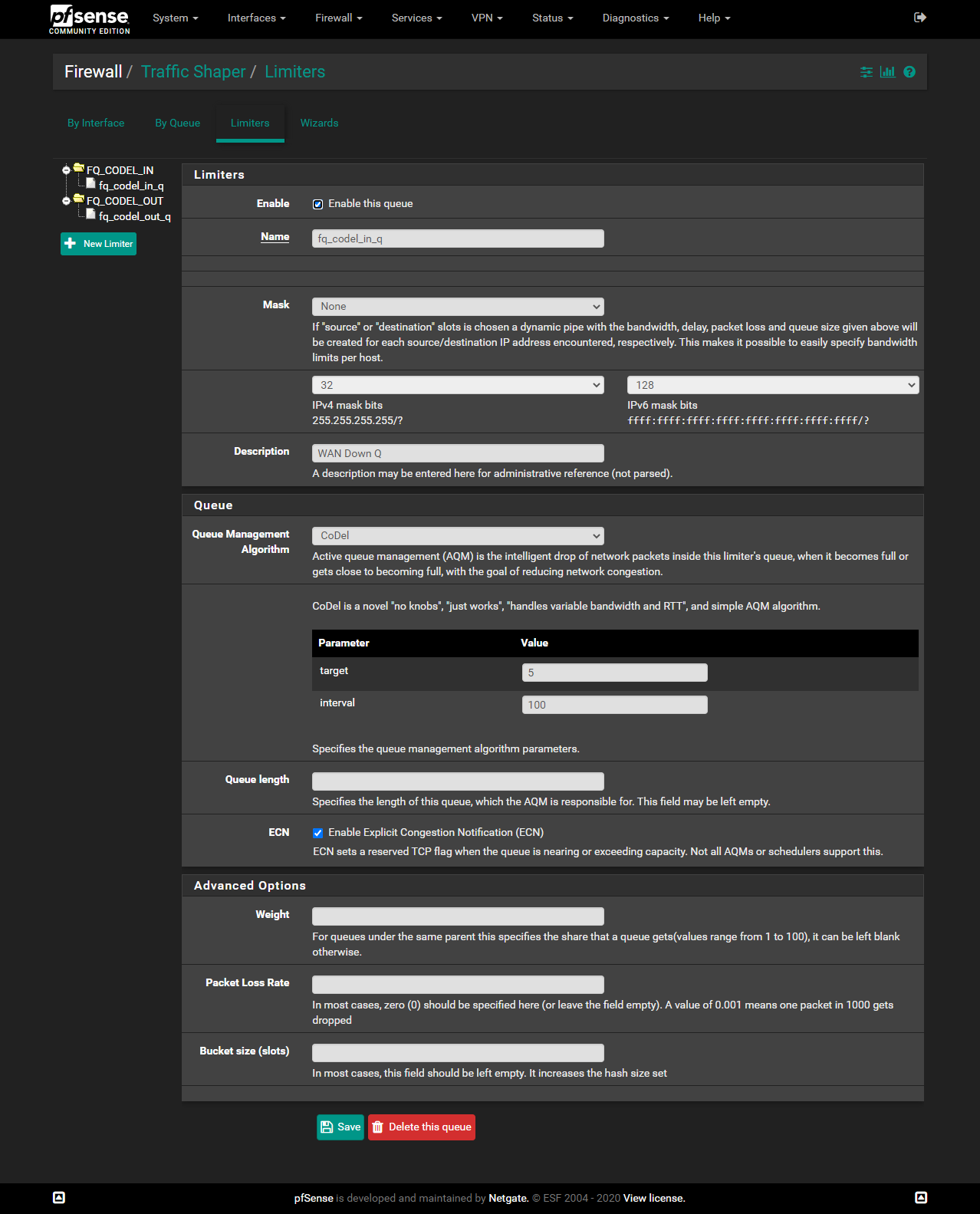

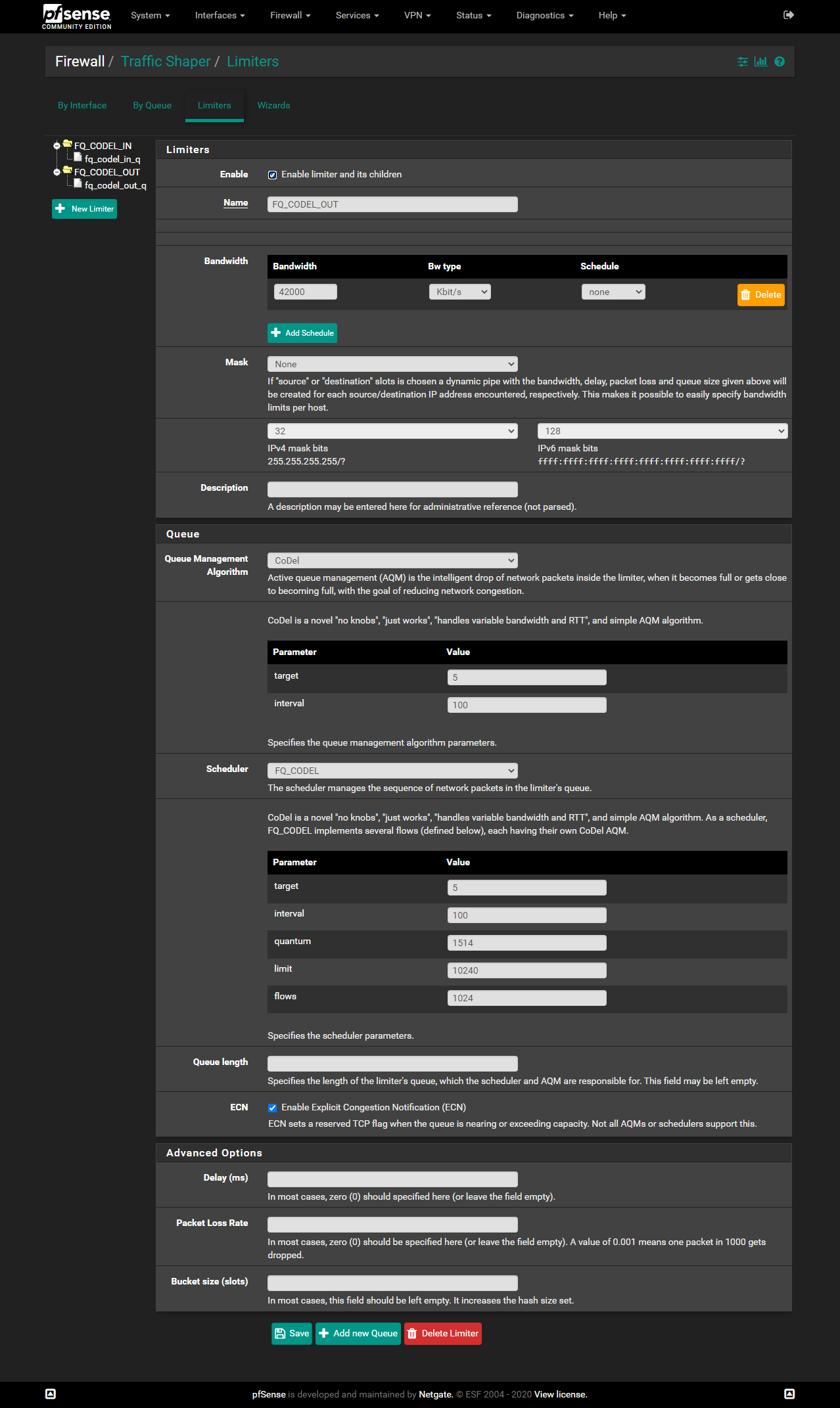

      I made the following settings under Firewall Traffic -> Shaper -> Limiters.

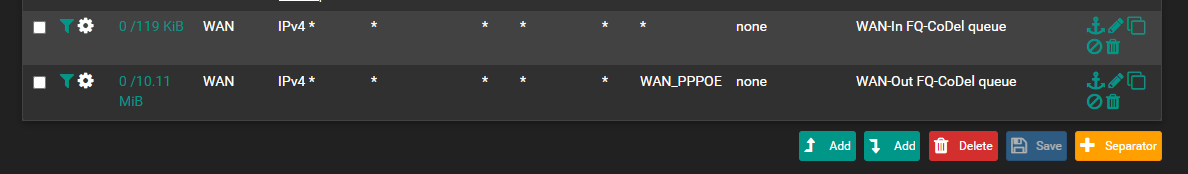

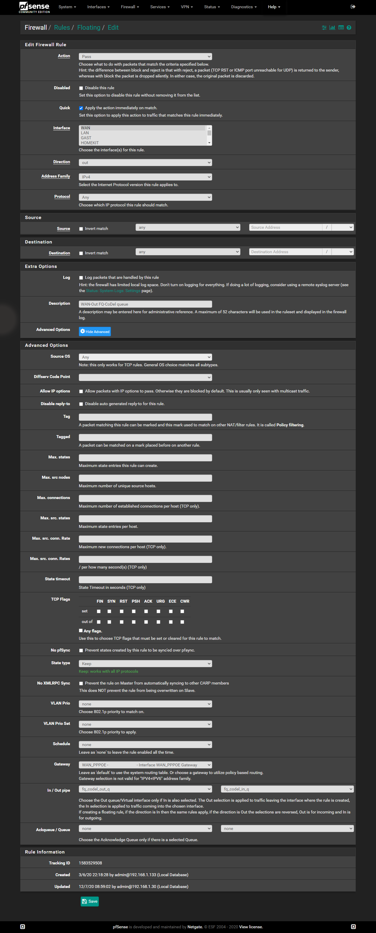

      Similarly, the corresponding floating Rule
      Here is a picture of my Hardware.
        stephenw10 Netgate Administrator @Lip
        Did the FQ-CoDel Limiters make any difference at all?
        We can't see the full config there but I assume you have it set as shown for, example, here?:
        https://youtu.be/o8nL81DzTlU?t=379
        Your firewall rules are incorrect. The out rule should cover both and needs to be set as Quick otherwise it will be passed by a later rule.

          Yes, the limiters make a difference. Bufferbloat goes from F to A.
          The problem remains the same. As soon as I download something and use the line, the ping goes up.
            Ok those rules and queues look correct.
            Do you actually see a reduction in available bandwidth when they are applied?
            The key is to have them set slightly below the available speed to that all the queuing is done in pfSense where it can control what is passed and when. You might try setting the values lower to be sure.

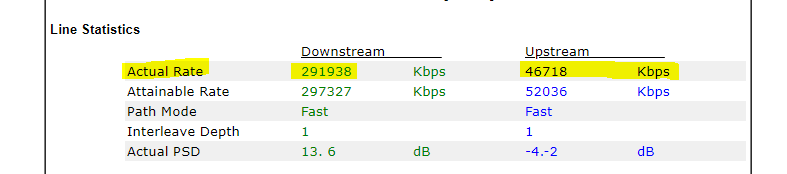

              The Vigor outputs the following values, in my thread above you can see my limits. I would say the limiter works?

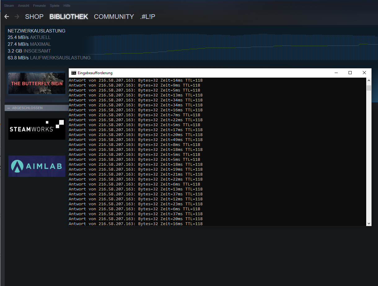

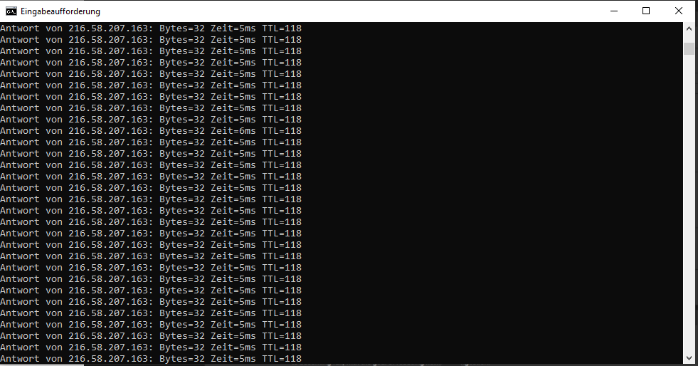

              But look at these spikes on cmd:
              And this is what my ping looks like when there is only little traffic on the line:

                        What are you pinging in that example?
                        Do you see the same variation to all external IPs?

                            I ping on www.google.de.
                            It doesn't matter what I ping.

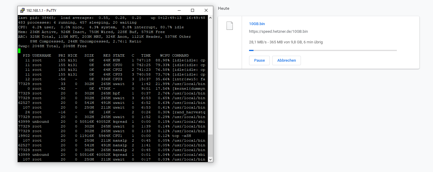

                                Mmm, the Celeron N4100 is not that fast. It's possible you're hitting something there though you are seeing the full bandwidth. I would expect it to pass 300Mbops without issues though. Maybe it's stuck at the lowest speed.
                                Try running at the CLI top -aSH whilst testing. See if one core at loaded 100%.

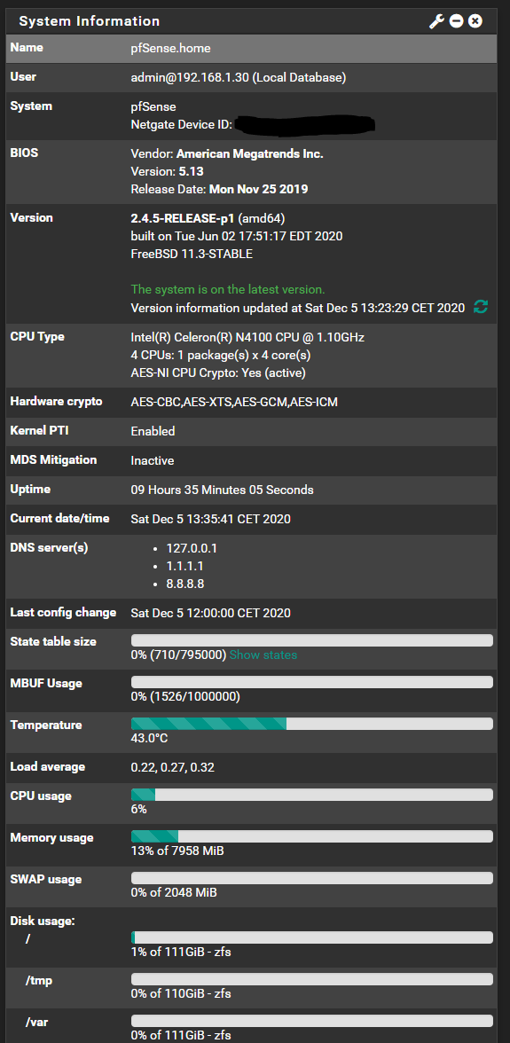

                                • L Offline
                                  Lip @stephenw10
                                  Here is a screenshot, is the CPU the problem?
                                    Nope. All 4 cores are at least 73% idle. That's only 224Mbps though.

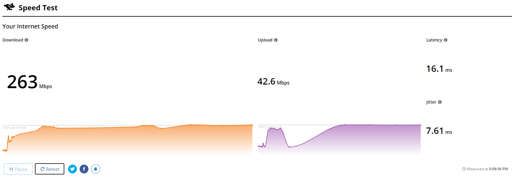

                                    I'm still not sure you're actually limiting that traffic though.
                                    What does the speed test result show when you disable the Limiters? vs with the Limiters?

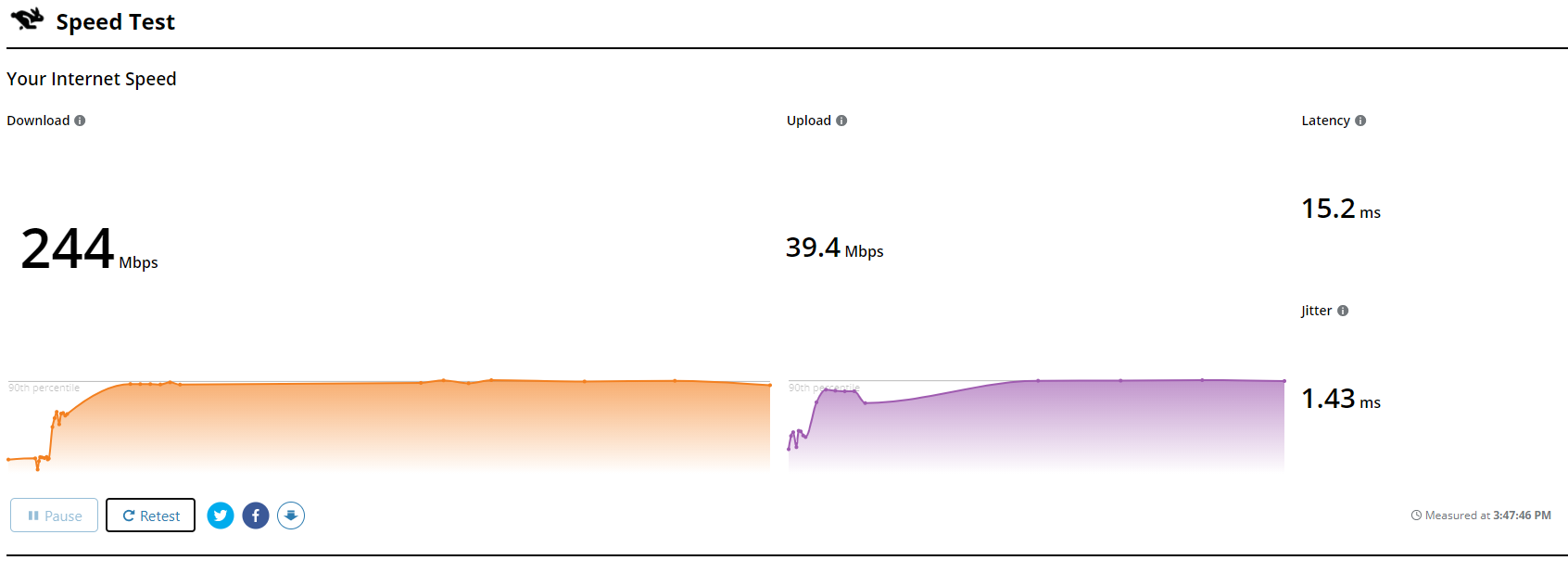

                                    • L Offline
                                      Lip @stephenw10

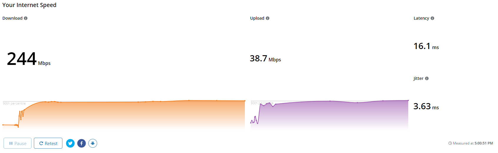

                                      Active Limiter
                                      inactive Limiter with States Reset
                                        Hmm, well that looks OK. Maybe more than FQ_Codel can deal with then.
                                        I don't actually see any packet loss there though, are you still seeing that?
