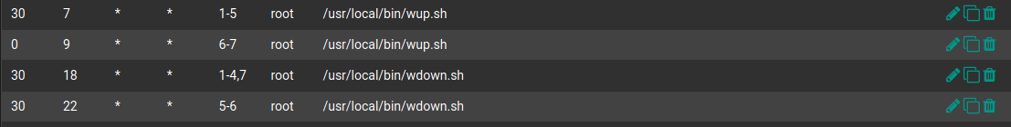

      Next, to control usage times, I created two small "scripts" as follows in /usr/local/bin:
      wup.sh:
      #!/bin/sh
      ifconfig ix1.5 up
      exit 0
      and
      wdown.sh:
      #!/bin/sh
      ifconfig ix1.5 down
      exit 0
      with corresponding cron rules as follows:
      I figure this ought to take the entire interface to his VLAN offline and block internet access outside of hours we approve of.
