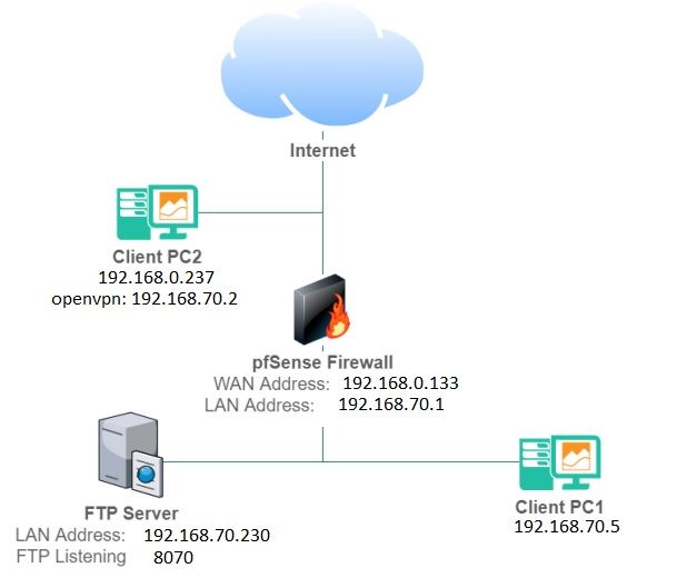

      Hi all. I am really new to pfsense and routing.
      I have this test environment where I want to allow an external client to access an internal webserver to a specific port.
      So far now I was able to set Openvpn rules that give the clien 2 host an internal IP but I am not able to ping any host. why?
      I dont know ho to proceede further in order to connect client 2 to server.
      I can think something like port forwarding but I am a bit lost that is why I am asking for help here.
      thanks in advance! ![alt text](Uten navn.jpg image url)

            • RicoR Offline
              Rico LAYER 8 Rebel Alliance
              Your drawing screams asymmetric traffic flow. Why is Client 2 connected to pfSense WAN and not behind pfSense (LAN)?

              • B Offline
                bostongeorge @Rico
                @rico Client 2 is an external client. Is not part of the internal network,
                I neet to simulate client 2 can connect to server on ftp port 8070.
                Client 1 can connect to server on ftp port 8070 (but they are on same lan segment so yeah).
                Client 2 has to request to the firewall the possibility to go to server.
                So firewall must allow that.

                  • B Offline
                    bostongeorge @Rico
                    @rico I understand that. I am testing all using VM
                    At the moment internally all devices can ping each other and external device can ping internal ip of firewall, but cannot ping internal server or internal pc1.

                          • B Offline
                            bostongeorge @tsmalmbe
                            @tsmalmbe I am now using this setup and all is working. I have followed a guide. so for the one interested let me know if you are in same problem (not sure i can post the link here).
                            I have follow this:
                            CONFIGURATION VM
                            pc real 192.168.0.0
                            FW bridged +Vmnet2 (host only)
                            Server custom Vmnet2
                            Client 1 custom Vmnet2
                            Client 2 bridged
                            IP ADDRESS
                            FW WAN 192.168.0.133
                            FW LAN 192.168.70.1
                            Client1 192.168.70.5
                            Server 192.168.70.230
                            Tunnel 192.168.60.0
                            Client2 192.168.0.137
                            Client 2 vpn 192.168.60.2
