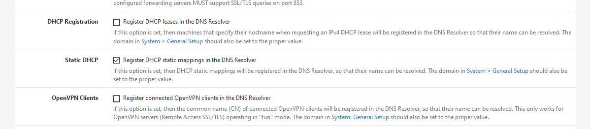

              @gertjan when I check the server is on green status means running but on LAN there is not DNS resolving . I'm using pfblockerng-devel 2.x version I have not updated yet . I don't to jump directly unless its safe to use with out bug so far. I've remove the check from DHCP registration for now and see what happen.
              If the issue still occurred then what's is the next step?
