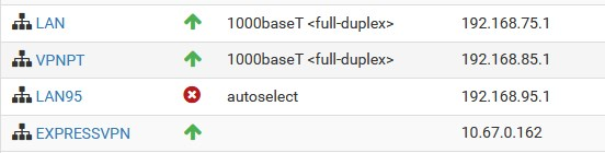

        I would do this as a first debugging step:
        Try without VPN, - through the pfSense... to ISP
        (since you can see the domain in question is resolved , -Lookup on BOX)
        set an interface where there is no VPN as outbound interface
        like here:
        LAN w/o VPN
        VPNPT w ExpVPN
