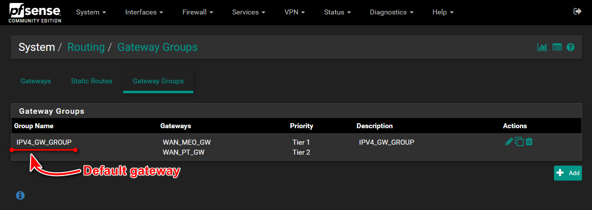

                • adbA Offline
                  adb @adb
                  To give more context to the settings I have, I leave here some screenshots
                  • N Offline
                    netblues @adb
                    @adb Since you created a gateway group, you need a rule on your lan to direct traffic to that group and not *, which is the default.

                        • adbA Offline
                          adb
                          Finally I managed to configure everything and? much simpler than I was thinking.
                          I will try to describe all (in fact there are only a few) the configurations I made.
                          As I currently have two connections to the internet, I have defined a gateway group wit the name "IPV4_GW_GROUP"
                          this gateway group has two internet connections:
                          • WAN_MEO_GW
                          • WAN_PT_GW
                          For this problem, the connection that matters is "WAN_PT_GW" which connects to the interface in "WAN_PT" that we will call WAN2
                          The "WAN_PT" interface is configured with "Static IPv4" and the IP is 100.64.67.74
                          Then it was only necessary to configure nat to translate all traffic to my public IP (virtual IP)
