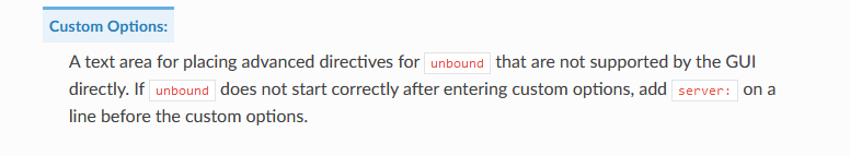

                    The manual :
                    doesn't link to the unbound man pages neither. Happy enough, some of us see the format right away :
                    It's
                    server:
                    and not, for example,
                    [server]
                    but I presume here that the user should know what a 'section' is. Or, as unbound (NLLabs) calls them : 'clauses'.
