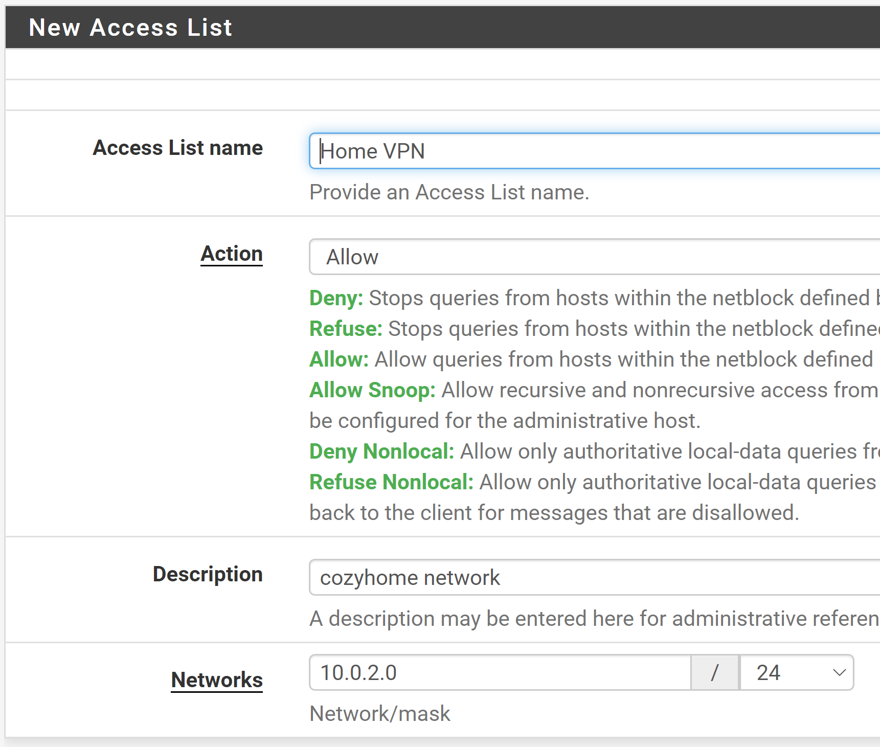

      • On pfsense.cozynet the DNS resolver has the 10.0.2.0/24 network configured in its access list (to allow queries from the .cozyhome network.)

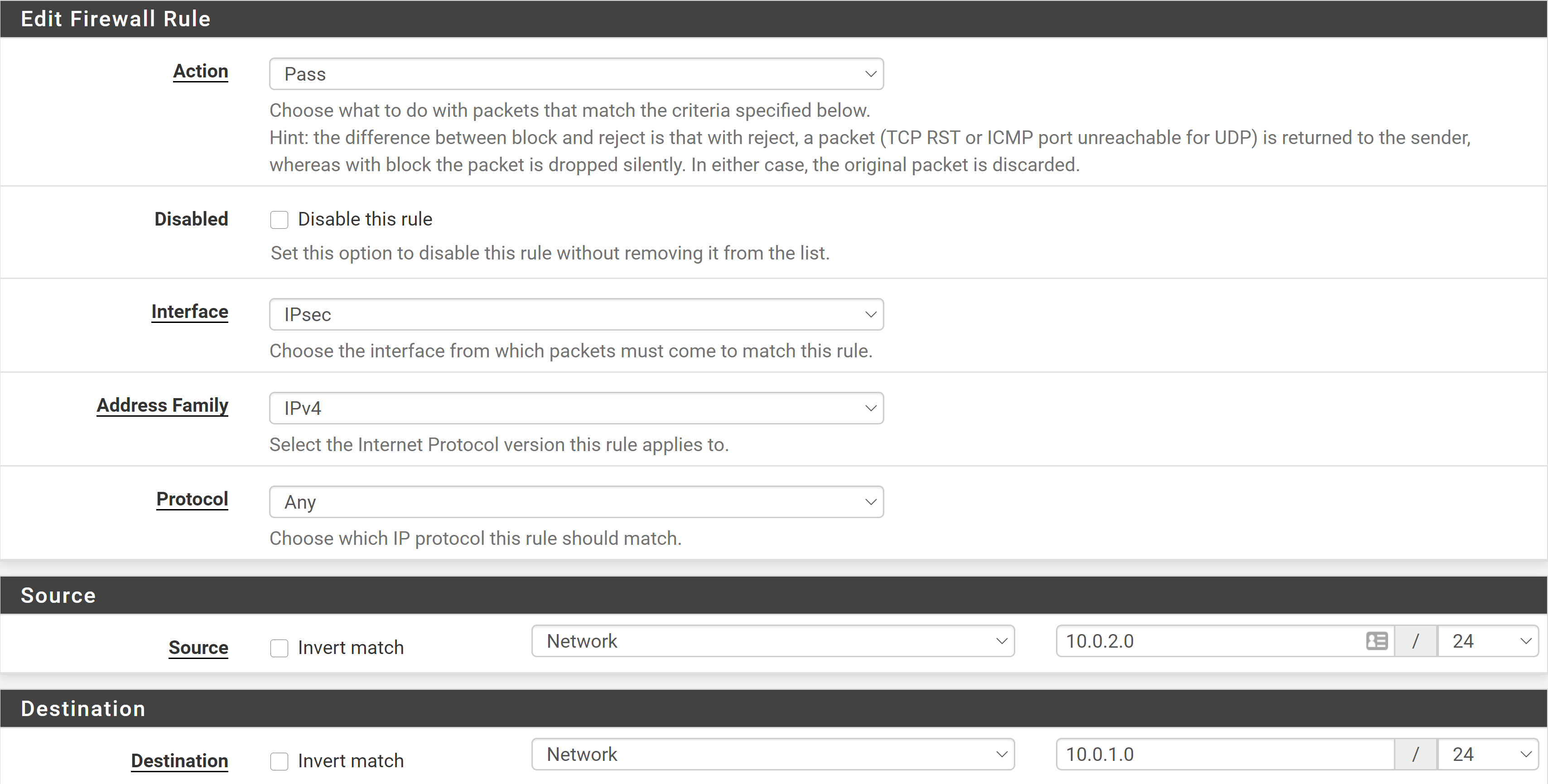

      • IPSec firewall rules on pfsense.cozynet are set to allow Any from 10.0.2.0/24 and all other traffic is otherwise working fine

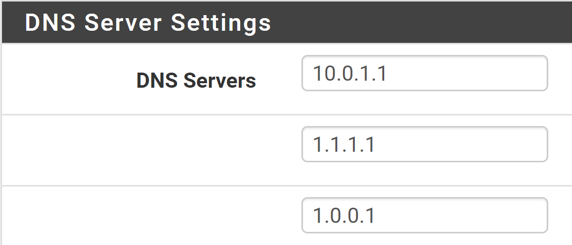

      • Additionally, pfsense.cozyhome has 10.0.1.1 in the DNS servers in General Setup to try that for queries

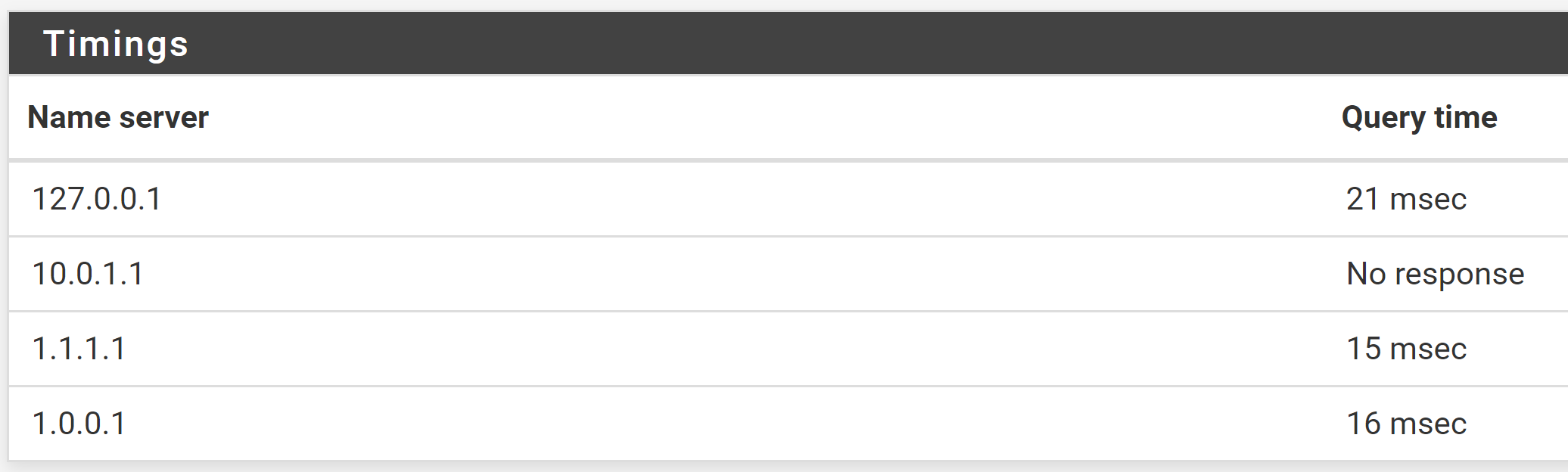

      When I do a DNS lookup from pfsense.cozyhome for a .cozynet hostname, the forwarding to 10.0.1.1 reports "No Response":
      I'm not seeing anything in the firewall logs that would indicate that these requests are being blocked.

          Got a little more info on this - I set the local DNS resolver logging to show queries, and when I query the cozynet domain from cozyhome I see:
          Feb 6 06:18:44	unbound	57298:1	debug: return error response SERVFAIL
          Feb 6 06:18:44	unbound	57298:1	debug: configured stub or forward servers failed -- returning SERVFAIL
          This is only happening for lookups for the cozynet domain, everything else is resolving properly
