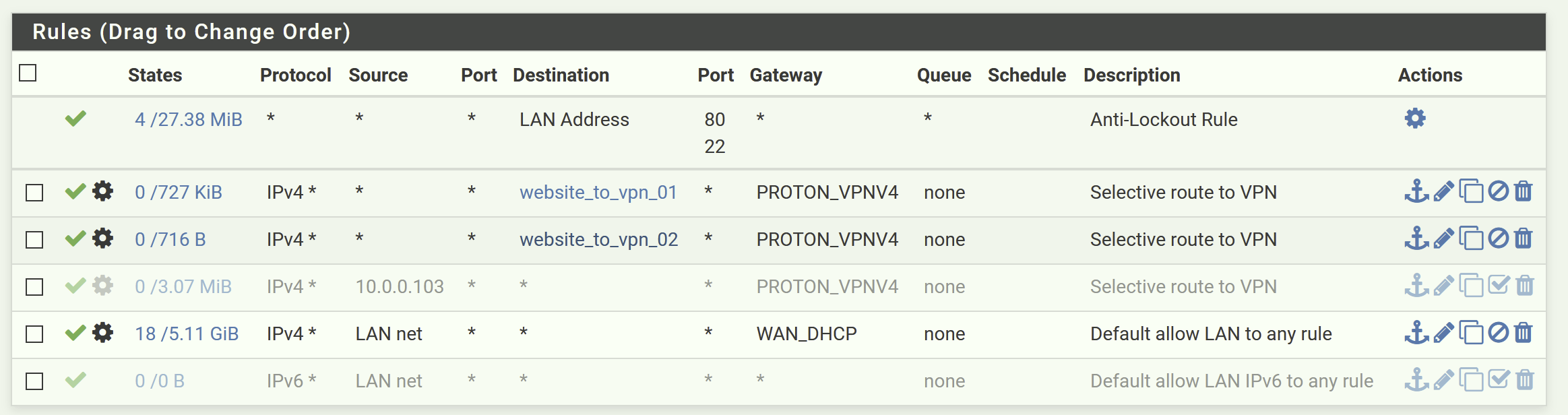

      i have a vpn client running with some selective routing so specific websites go through the vpn and not my isp.
      im currently using some aliases for the selective routing so i route specific ip's via the vpn.
      my question is related when i perform a tcp traceroute from my windows pc connected to the lan. even though the selective routing works as i get the vpn ip address when i access, a vpn-routed website like ifconfig.io, performing a tcp traceroute will only show one hop. why could that happen?

              I will also note that the policy routing for imgur is unlikely to work well as those fqdns are almost certainly resolvable to numerous IPs but the alias will only resolve them once when the ruleset is updated. Same as this:
              https://docs.netgate.com/pfsense/en/latest/recipes/block-websites.html#using-firewall-rules
                andresmorago @stephenw10
                thanks
                im using specific imgur servers as example and they do look so far. traffic goes through the vpn, but the annoying 1 hop still shows
