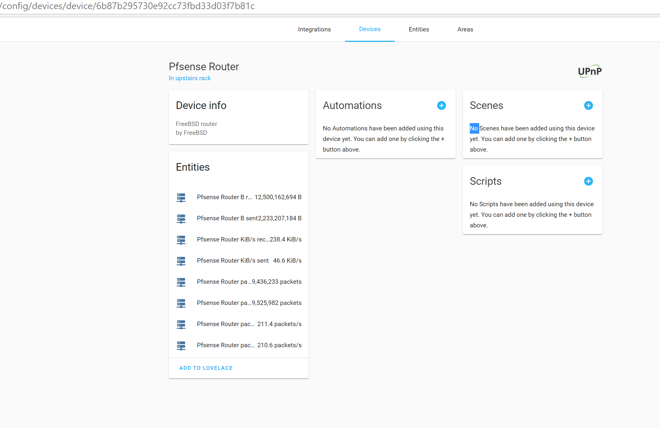

                          and i made mistake wasnt MQTT was UPnP pfsense is broadcasting
                          so i hoping i get get Uptime and WAN and PPOE through the UPnP broadcast
                          C A 2 Replies Last reply Reply Quote 0
                            comet424 @comet424
                            it reports packets in home assistant for pfsense.. the numbers are high because pfsense hasnt been rebooted in a while.. its re downloading games from epic games its a pain. and slow
                            i have even tried reset states and filter reload but thats never fixed it
                            reason i was hoping i could get Pfsense to broadcast the connection info then if it shows "-" when modem goes down or lines home assistant would reboot a raspberry pi would reboot the modem.. like the guys script thats what i was asking for or an arduino..
                            as for Pfsense its workigh right now.. but when i loose internet connection PPOE "-" shows a dash so reason i trying to find a way if Internet goes to "-" instead of an IP Address then reboot a Arduino or Raspberry pi... and ill loose modem connection with or without downloading..
                            and i cant afford a new modem as they make you buy a new modem only a 1 year warrenty then your have to buy a new one
                              comet424 @comet424
                              @stephenw10 here is screen grabpf.PNG of home assistant
                                comet424 @comet424
                                and that miniupnp website didnt work
                                but ill google it.. and pfsense to see if it can broadcast ip address or what not
                                  The link didn't work? Weird, works fine for me.
                                  One thing that UPnP IGD should be able to do it report the WAN IP so that should tell you if the modem is up.
                                  For some reason though that doesn't work for me here:
                                  steve@steve-MMLP7AP-00 ~ $ upnpc -s
                                  upnpc : miniupnpc library test client, version 2.1.
                                   (c) 2005-2019 Thomas Bernard.
                                  Go to http://miniupnp.free.fr/ or https://miniupnp.tuxfamily.org/
                                  for more information.
                                  List of UPNP devices found on the network :
                                   desc: http://172.21.16.1:2189/rootDesc.xml
                                   st: urn:schemas-upnp-org:device:InternetGatewayDevice:1
                                  Found a (not connected?) IGD : http://172.21.16.1:2189/ctl/IPConn
                                  Trying to continue anyway
                                  Local LAN ip address : 172.21.16.5
                                  Connection Type : IP_Routed
                                  Status : Connected, uptime=645s, LastConnectionError : ERROR_NONE
                                    Time started : Tue Feb  2 00:24:41 2021
                                  MaxBitRateDown : 1000000000 bps (1000.0 Mbps)   MaxBitRateUp 1000000000 bps (1000.0 Mbps)
                                  GetExternalIPAddress failed. (errorcode=501)
                                  Bytes:   Sent: 2907268482	Recv: 870088557
                                  Packets: Sent: 106471691	Recv: 147320624
                                  It could be because it's an internal device and miniupnpd sees a private WAN IP as invalid.
