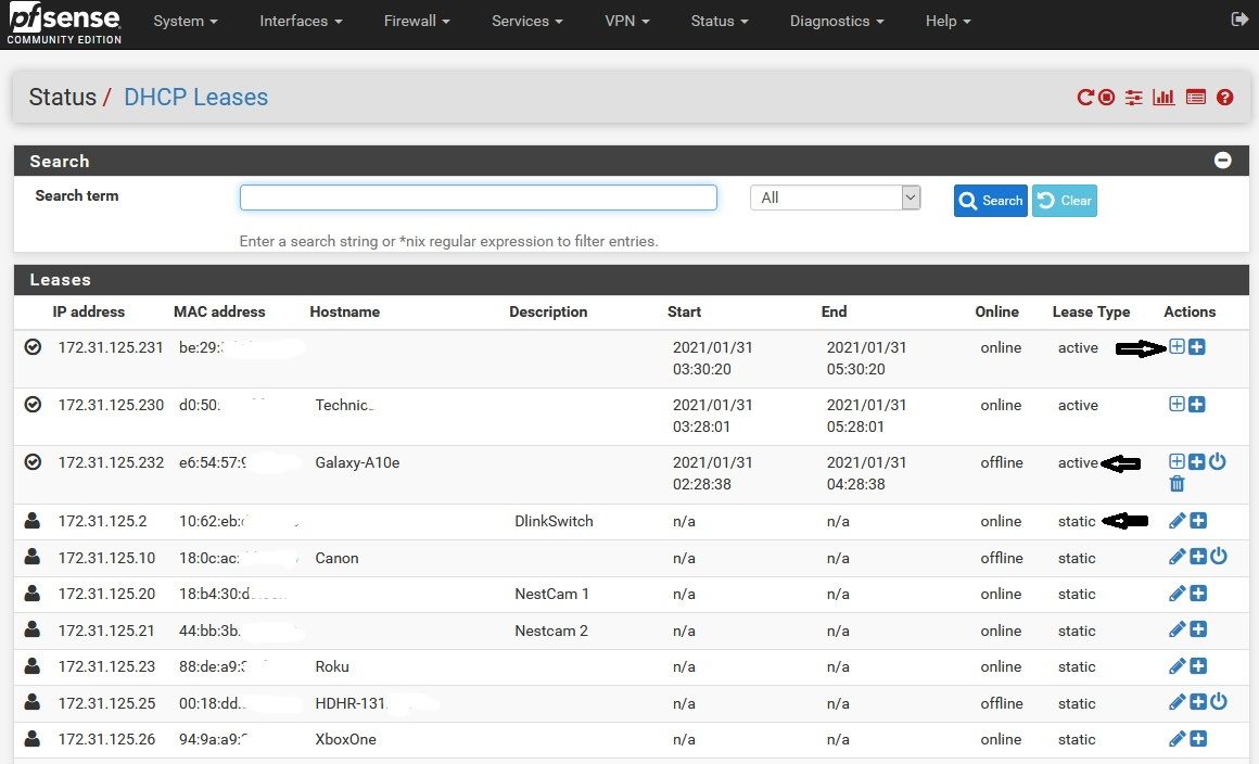

        Almost every machine on my local network here is given an address assigned to it using my pfSense DHCP server.. As long as the interface MAC address is the same it will always get the address I set for it..
        In the picture below you can see where the top arrow is.. click that.
        Difference is show at the second and third arrow.
        Is that what you are speaking of?
