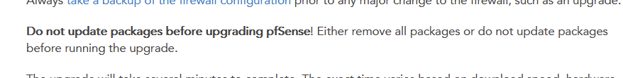

        Upgrade pfSense to 2.4.5-p1 (february 2021).
        If there is a reason to stay on an older version of pfSense : ok, up to you. But, do what the doc says : do not upgrade packages any more !
