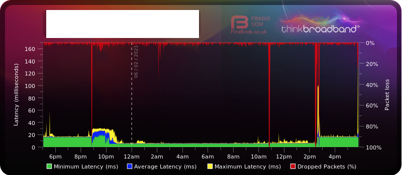

            a little bit more info around packet loss both externally:
            and from within the network:
            Data summary of the second graph:
            Data Summary
            Minimum	Average	Maximum	Last	95th Percentile
            packet loss	0.00 %	3.07 %	20.31 %	15.94 %
            delay average	15.98 ms	16.80 ms	23.35 ms	19.97 ms
            delay std. dev.	0.21 ms	1.08 ms	19.47 ms	2.91 ms
            inpass (right axis)	96.85 kb/s	32.88 Mb/s	267.55 Mb/s	262.10 Mb/s	260.53 Mb/s
            outpass (right axis)	21.26 kb/s	886.69 kb/s	6.50 Mb/s	6.27 Mb/s	6.24 Mb/s
            inblock (right axis)	185.04 b/s	419.60 b/s	774.30 b/s	185.04 b/s
            outblock (right axis)	0.00 b/s	0.00 b/s	0.00 b/s	0.00 b/s
            inpass6 (right axis)	0.00 b/s	0.00 b/s	0.00 b/s	0.00 b/s	0.00 b/s
            outpass6 (right axis)	0.00 b/s	160.00 mb/s	9.60 b/s	0.00 b/s	0.00 b/s
            inblock6 (right axis)	0.00 b/s	0.00 b/s	0.00 b/s	0.00 b/s
            outblock6 (right axis)	0.00 b/s	0.00 b/s	0.00 b/s	0.00 b/s
            inpass total (right axis)	96.85 kb/s	32.88 Mb/s	267.55 Mb/s	262.10 Mb/s	260.53 Mb/s
            outpass total (right axis)	21.26 kb/s	886.69 kb/s	6.50 Mb/s	6.27 Mb/s	6.24 Mb/s

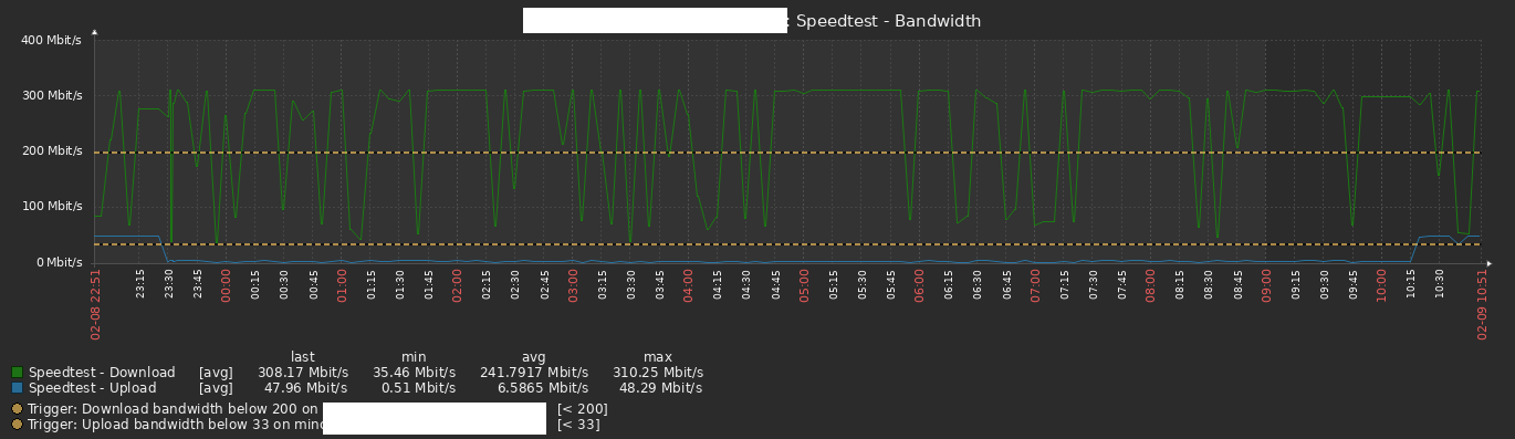

                      Here I'm running Speedtest every 5 mins and log the result in Zabbix (network monitoring tool). Interesting variation between the two routers - the swap occurred 23:20 ish on 8th Feb and then swapped back the next morning at 10:15 ish:
                      BQM - pfSense on left - Fritzbox on right:
                      Speedtest - Bandwidth:
                      Speedtest - Jitter/Latency:
                      You can see the status with the pfSense box on the left and the ISP provided Fritzbox 7530 on the right in BQM.
                      Fritzbox is definitely more consistent in performance but it's still quite up and down unless that's normal...
                        I've never generated data like that but I pretty always see 140Mbps when I run a test against, for example, fast.com. I've never seen it below 130Mbps.
